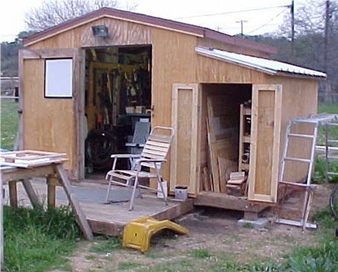

    The Playen door is 4' wide and simple construction. 2x4 frame with a plywood (1/4" I think) skin glued and screwed to the outside. It is painted and I haven't had any warping problem. It is now covered by an awning that was put up a couple of years after it was built.
    I realized how old this piture was when I looked at it after posting. Still has the original 6x8 deck that I put the BT on to work!

    The new storage barn has sliding doors that are 3' wide each. 2x6 frame with pocket screws and 1/2" ply set it a groove. This is only 6 months old so too early to tell if I will have any warp problems.

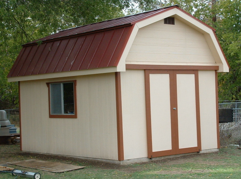

        This picture is about two years old, but it shows the structure and what the doors look like.
