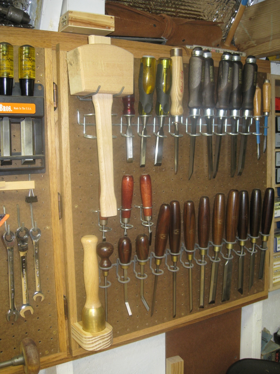

I finally got around to making a holder for my brass mallet. I didn't want to drill a hole in the handle or add a strap or hook in the end to hang it. Just a piece of 2x syp scrap from my bench build a few years ago with a hole for the brass head and fastened to the door with a couple screws from the other side. Simple, but it's been needed for a while. It used to just sit on the bench, but it was always getting knocked over when I opened the doors above.

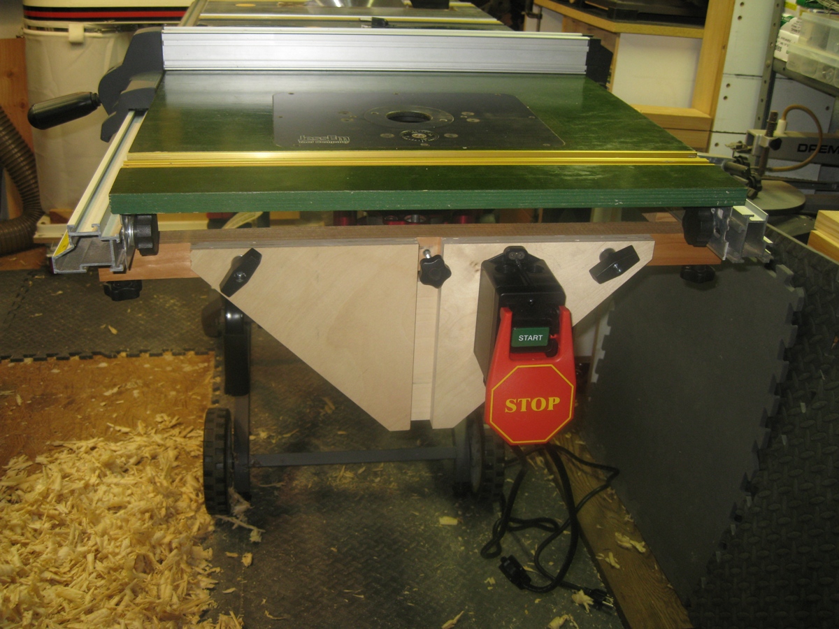

I made a leg stabilizer for the saw router extension and finally mounted my peachtree paddle switch I got last spring. It sure did help stabilize the saw. The leg still attaches at one point, but the saw top won't pivot around it anymore. The leg comes off just as easily as before so I can fold the saw. I'll probably whack myself in the nose with the protrusion sometime when moving the saw now.

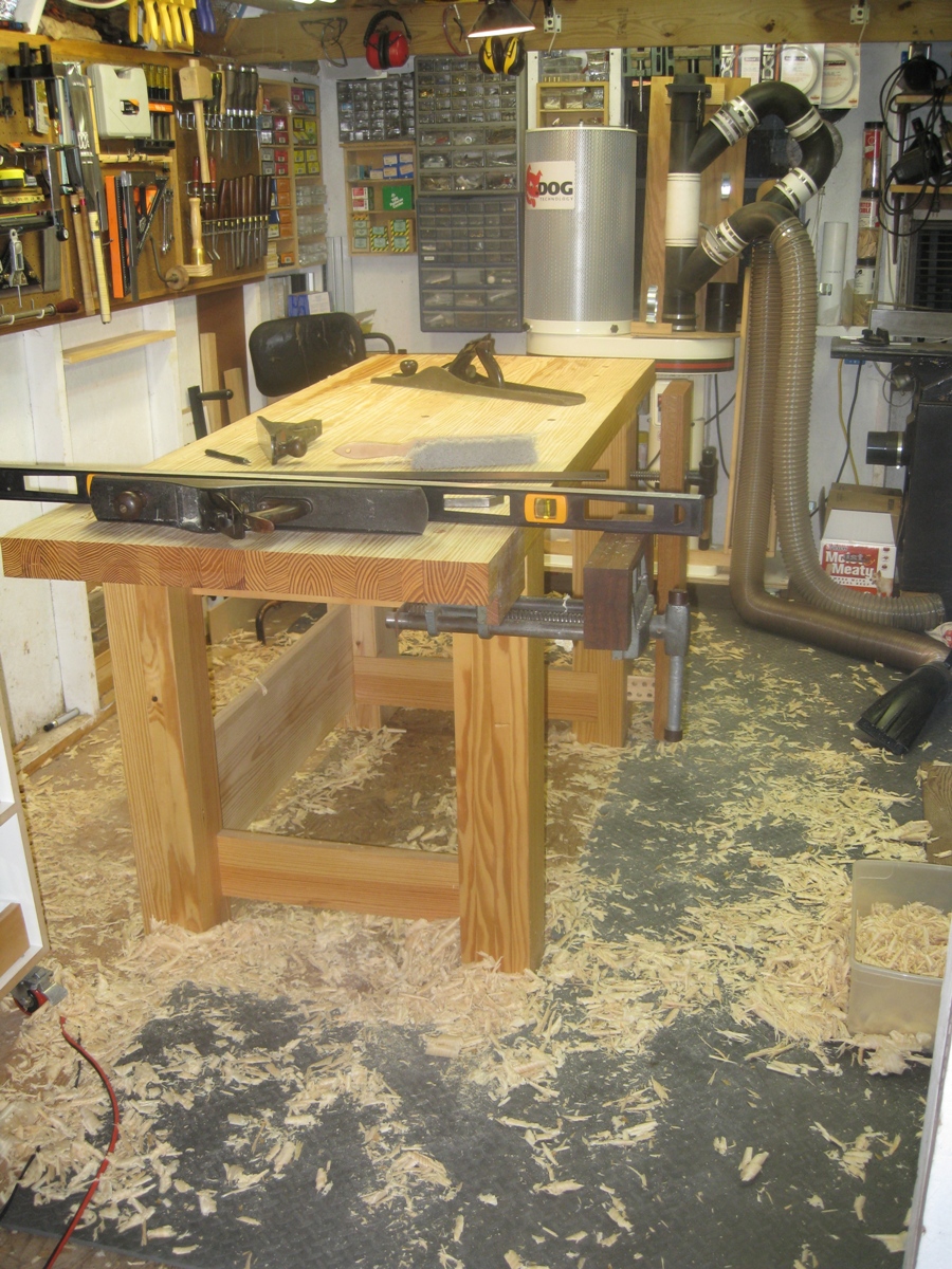

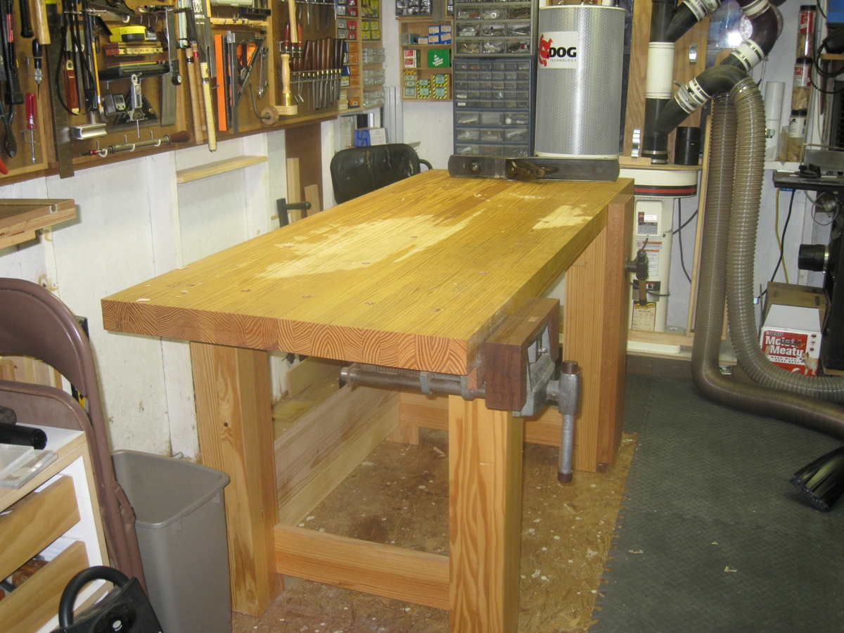

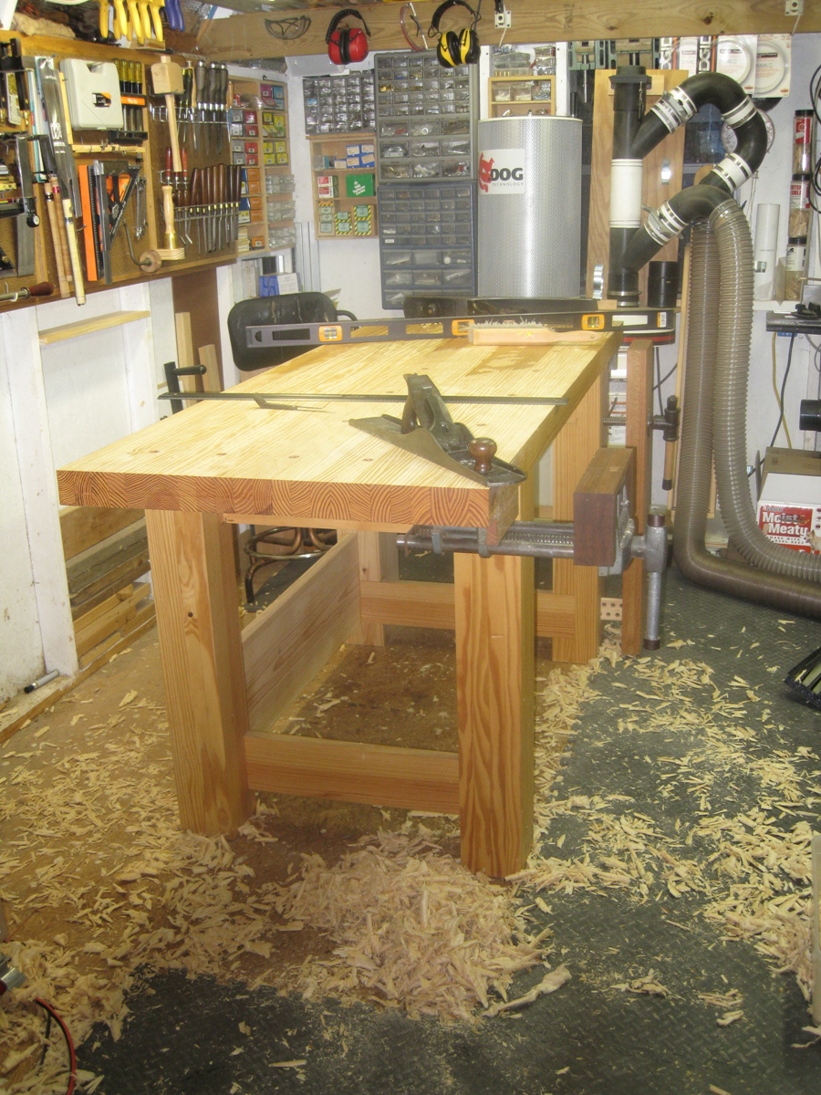

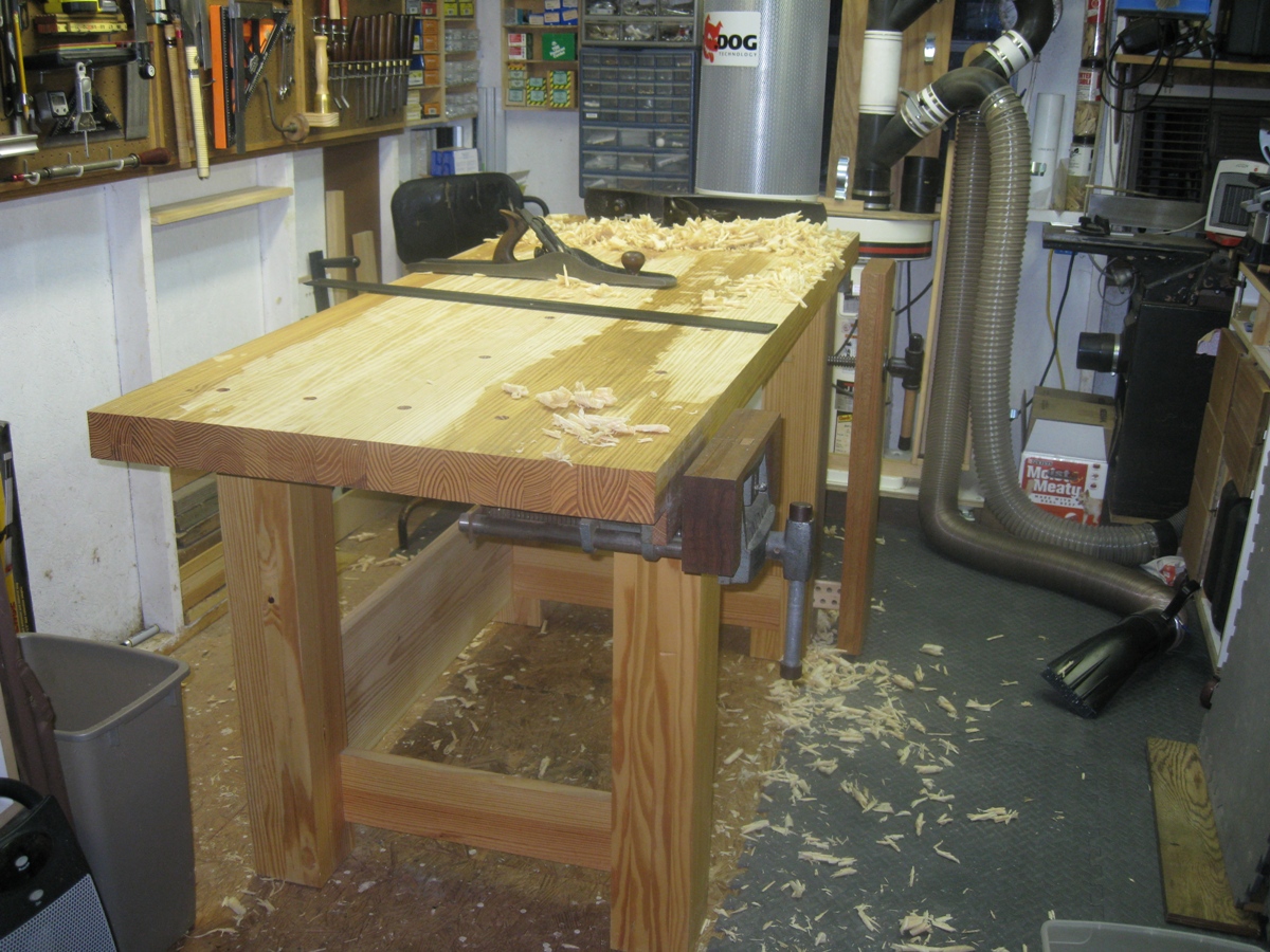

I got a good workout flattening my benchtop (feeling a little sore this morning). I haven't flattened it since the initial build three years ago. My 100 year old Stanley No 7 and No 8 worked beautifully, especially after I sharpened them (been a while). Half a dozen Guinness’s later I got it pretty flat. Most of the rest of the top is well under .008 flat. I couldn’t find my thin feeler gauges to see how close I really got it. The back right corner is still a little low, and it is going to stay down there. There’s no way I’m going to take the whole 30x73 top down to it. That area doesn’t get much use anyways, mostly a clutter repository. A few spots will get hit by my smoothers and scrapers once I get them sharpened today. I still need to take down the top of the vices. I’m not looking forward to doing that red oak endgrain of the leg vice chop.
