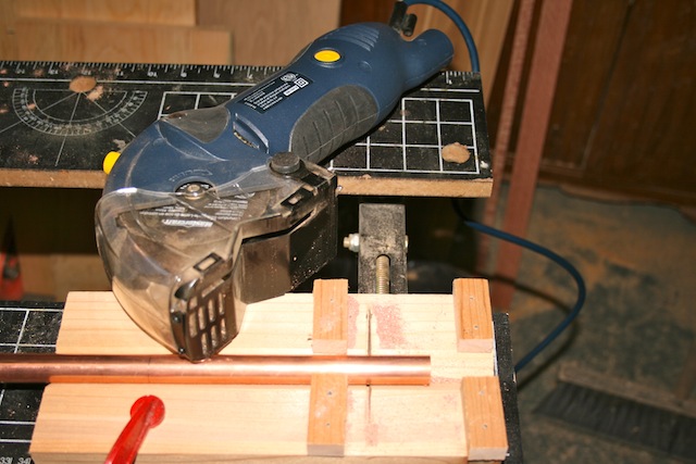

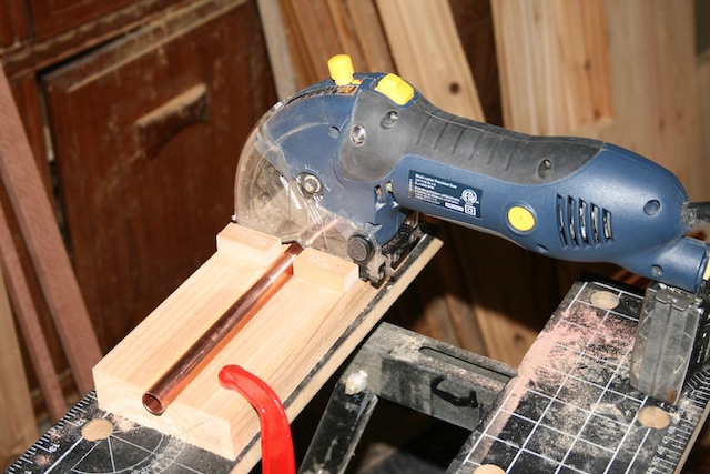

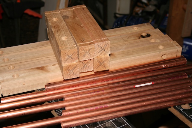

    I am working on a project that uses 1/2 inch copper pipe as rails. About 15 feet of pipe all cut to smaller lengths from 12" to 24". Too many cuts to go with a pipe cutter. Ideally a cutoff wheel in my CMS would work but I don't have a cutoff wheel and wasn't going to buy one for this one job. A few Christmases ago LOML bought me a multi saw that came with a small cutoff wheel and pipe cutting attachment. Woohoo! Now there were still a lot of cuts and I wanted to make it safer( always a good thing) and easier to make repeatable. I just line up my cut mark to the kerf cut into the jig. By using a scrap bit of cedar I built such a simple but perfect jig that I'm going to install a screw eye and hang it from the shop ceiling for any future use. The tape measure in the second pic is just to hold the saw up for the picture and the last picture is shows some of the pipe that I already cut through.
