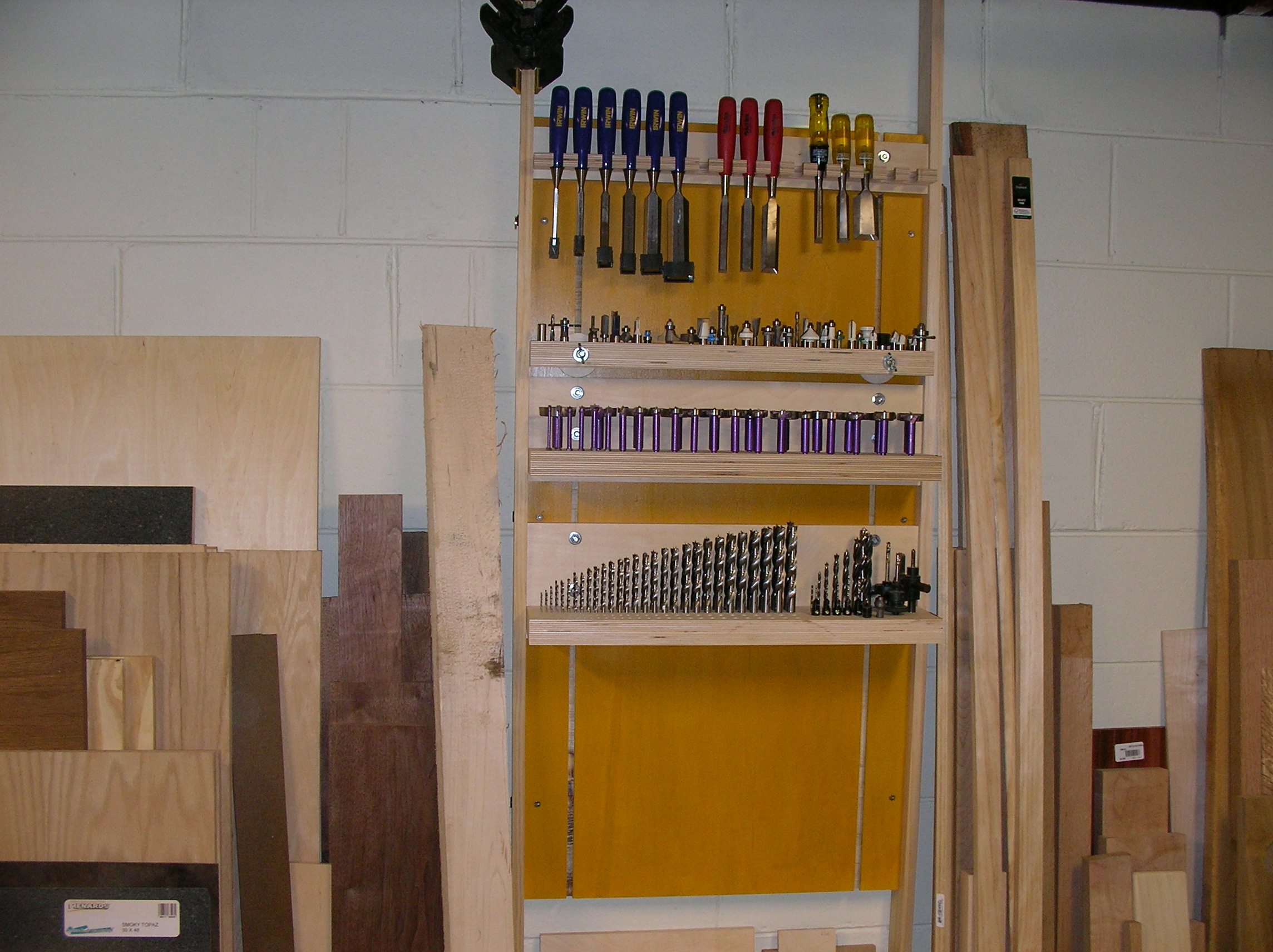

    After the first wall, I had to stop and figure out a way to store four large shelves of tools/stuff so I could ditch the steel shelves and continue.
    I tried shelf standards attached to the wall I had completed, but the walls were less than straight.
    So I created some cleats between joists on top of the walls, then I made some hangers with 1x material and some rafter hooks from the hardware store. My shelving unit and my tool rack hang from two of these hangers each. This way I can slide them around and even move them if I like.
    The tool hanger will hold all my bits. Having bits in boxes (even nice ones) on shelves turned into a PITA, as I was constantly having to get the box out, find a spot for it (for example, top of table saw) and then having to move the open box again when I needed to use the saw. I wanted everything out and ready.
    The tool hanger is really just a piece of plywood with two t-slots routed into it, and assorted BB plywood holders. Still have one for my hand tools to finish-up.
    I used mostly materials on hand. The plywood carcase for the shelf and the plywood t-slotted rack are cheap plywood from Home Depot. The WO shelves for the hanging shelf was provided as a return favor for helping w/ someone's PC (there is quite a bit more, and he is bringing even more--good to do favors for guys w/ Wood-Mizers). I had the BB plywood. Even the milk paint was on-hand. This was my first attempt at milk paint. I like it, will be using it more. Put it over crap plywood and your end product looks fairly decent.
    I still have a little more work to do, but whatever doesn't fit on these two things will go up in the ceiling in little "garages" I'm making for pneumatic tools, etc.
    Part of my goal was to really de-clutter the shop. So having a place for everything, and everything in its place, is my ultimate goal.

    Wow! Now that's a shop my LOML would be proud of!
    Somehow it reminds me of Rod Kirby's shop, wonder why...
    That's a neat look you have achieved. You'll now want to spend all your time there!
    - Aristotle

      Very nice! (Using pocket screws to fasten to your ceiling joists? That's getting serious!) Nice work!

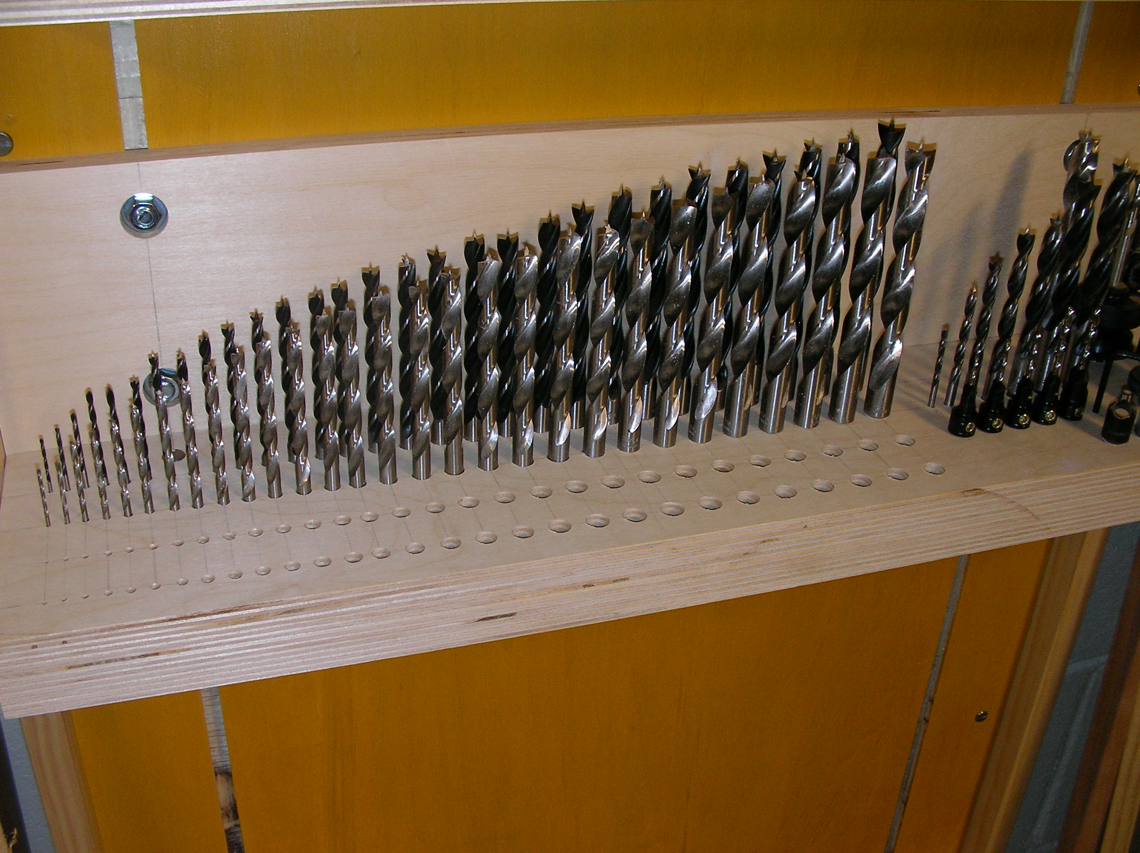

        you have more drill bits than i have tools
          That one block has enough room for four 29-bit sets.
          Two different rows of brad-point bits, and one row of split-point bits. One row for future expansion.
          The other block is 31 carbide-tipped Forster bits.
          I got to the point a few years ago where I got tired of never having the right sized bit.
