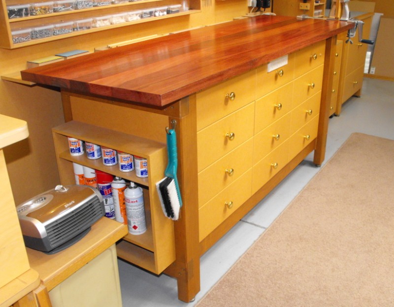

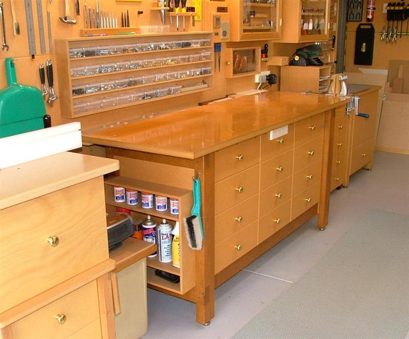

    Well, after “living with" my HDF (HIGH density fiberboard) bench top for several years, I decided to replace it. The !@#$%^&* thing was never flat! I had a job that needed to be clamped to the bench and the whole process was made very difficult because the front 6” of the bench was tipped down about 1/32” – may not sound like much, but very irritating.
    I have always loved the color and grain of Jarrah, and because it only grows in my home State, I went chasing a bench top made of it. I’d like to say I laminated it myself, but I confess, I found a place that specializes in Jarrah workbenches.
    http://www.workbenchworld.com.au/contact.html
    I was able to get a top 1800mm (45.7”) x 600mm (31.5”) x 32mm (1-1/4”) thick – the same size as the old one. It weighs 88lbs. The cost – US$300 including shipping (=say LA to NYC)! This is a VERY good price.

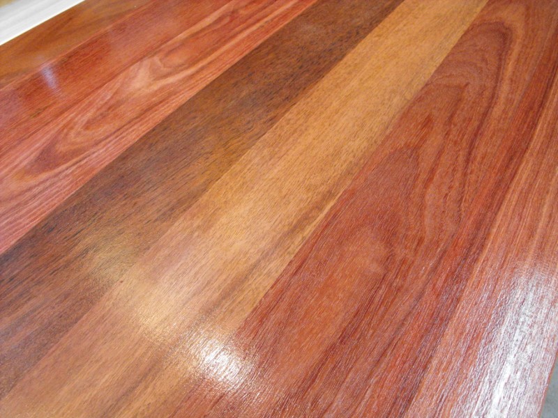

    The top arrived finish sanded (all surfaces) to about 320 grit –AND- it’s dead flat!
    I finished it with High Gloss (Flooring) water-based poly – 1 coat on the back and 4 coats on the top and edges – beautiful grain. I also decided I don’t need dog holes. I’m a very happy camper! I’ve included some details on the properties/uses of Jarrah.
    Old Top/Ready to attach

    Beautiful?

    Jarrah - the timber
    Jarrah (eucalyptus marginata) is the ideal timber to use for the construction of workbenches. It has a superior hardness, weight and load bearing ability to European and North American bench timbers. It has remarkable durability, outstanding resistance to fire and termite attack and is impervious to most acids. Jarrah is one of a few timbers that doesn’t set off a chemical reaction when trapped in close contact with metals. It is a preferred timber for the production of charcoal.
    Jarrah has been sought around the world for use in hostile environments, for example as railway sleepers in Australia, India, South Africa and the United Kingdom (London underground). It has also been widely used around the world for the construction of wharves and bridges. Jarrah has been used as a road foundation throughout Europe for major thoroughfares, for park benches in New York and for exterior paving blocks in Japan.
    Jarrah grows in the lateritic soils in the south west of Western Australia. The rainfall in this area is between 650 and 1250mm. Jarrah is the principal commercial timber tree of Western Australia. The area of prime jarrah forest is approximately 1,215,000 hectares although a more open type of forest occurs over a much larger area. There is a mixture of regrowth and old growth forest, with all old growth jarrah forest in conservation reserves.
    The tree reaches a height of 30-40m (100-130ft), with a diameter up to 2m (7ft). It has a straight slender trunk, with rough and stringy bark which has a fibrous texture. The tree is slow growing, taking 30 years minimum to harvest. Roots often go down to great depths in search of nutrient and water.
    The main historical uses for the timber are for wharf and bridge construction, poles, piles, railway sleepers, girders, veneer logs, sawlogs. It is a superb furniture timber with beautiful figure and colour. The timber is relatively easy to work and takes a polish well.
    Western Australia has timbers with more strength or a hardness factor up to 18kN but none offer as much overall as jarrah.
    At 12% moisture content density is 820 kg/m3, Modulus of Rupture 112MPa, Modulus of Elasticity 12 970 MPa.
    Jarrah has a hardness factor (dry) of 8.5kN (kilo Newtons) compared with:
    Sugar (rock) maple from Canada 7.3kN
    Sugar (rock) maple from U.S.A 6.4kN
    European (red) beech (the hardest beech) 6.4kN.
    American white oak 6kN,
    Scandinavian birch 5.5kN
    Teak 4.5kN
    Maritime Pine 2.7kN

    Rod, that is incredible. Surely to beautiful to use as a workbench!
    • Rand
      • 492
      • Vancouver, WA, USA.
      Very, Very NICE!
      You should put an MDF cover over that so you don't mess it up when you work on it.
      Rand
      • jkristia
        • 114
        • Simi Valley, CA
        that is beautiful, and too beautiful for a workbench, it looks more like a living room funiture
        Jesper
          Sweet! Really sweet!
            Won't be long and you will be wanting another one.
            • RodKirby
              • 3136
              • Mao Shan TSC-10RAS
              No - this one will see me out
              Downunder ... 1" = 25.4mm
              • jussi
                • 2162
                Beautiful top Rod. What was the name of the store you got it from? Where are they located?
                  That is gorgeous, Rod. I can attest to Jarrah's hardness, as I have turned some pens from it in the past... Do you know how they did the edge-joining? (biscuits, dowels, straight glue-up) And what type glue was used? (Jarrah is a somewhat oily wood, and I had some trouble glue-lamming a couple of blanks.)
                    • 8803
                    VERY Nice! Is this the beginning of more alterations? Thanks for showing the picts!
                      Beautiful top...almost too nice to ding up. You should have sectioned it and glued it back together for the sake of woodworking.
                        That new top is gorgeous Rod. I agree with the others - it is too nice to use as a bench top.
                        • Shep
                          • Nov 2008
                          • 710
                          • Columbus, OH
                          • Hitachi C10FL
                          Dings aside, I'd be afraid to glue anything up on a table like that. Nice.
                          -Justin
                          shepardwoodworking.webs.com
                          ...you can thank me later.
                            How many will that seat for dinner?
                            • Knottscott
                              • 3815
                              • Rochester, NY.
                              • 2008 Shop Fox W1677
                              Harder and prettier than plain maple or beech IMHO. Excellent! Good to see you working out in the shed again!
