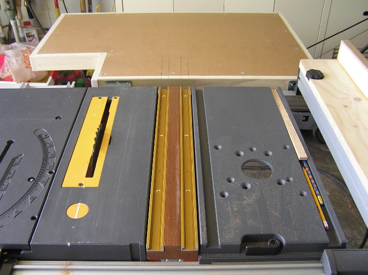

    Borrowed this design from the recent posting by JoeyGee (who credited Gugie with the design).

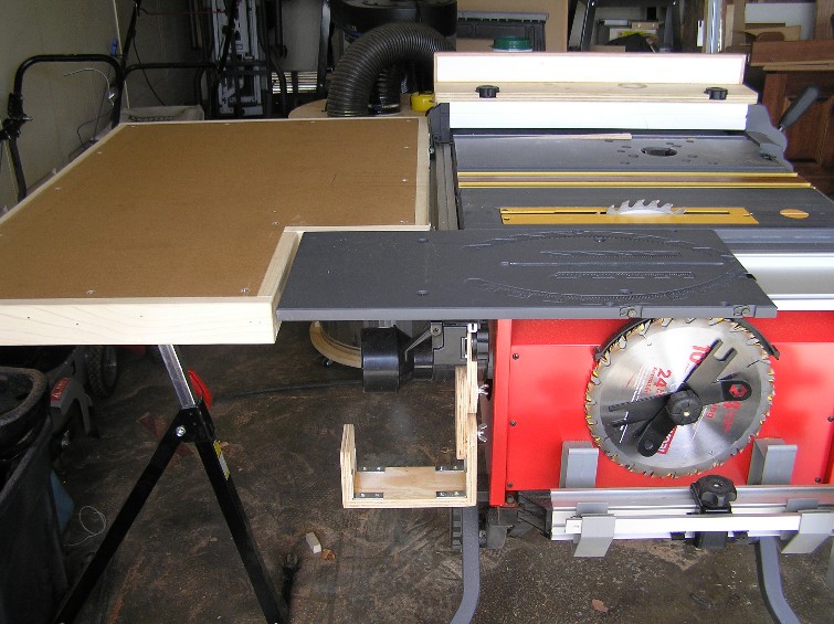

    Substructure is an old hollowcore 30in door, which I cut in two - a 35in wide piece for the outfeed table, and the 43in remnant for a small project table surface.

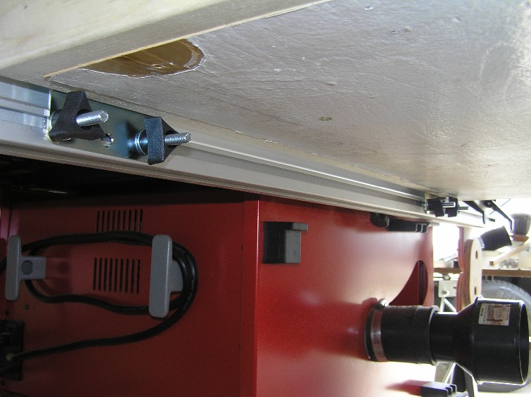

    The outfeed table is surfaced with a 1/2in MDF substrate and topped with removable hardboard (thanks to those who suggested this approach). Edged with poplar. Only thing left to do on the top is route the dados for the miter bar channels, and apply some wax. Attaches to fence with hinges by t-bolts & star knobs in the back rail, supported at rear by roller-stand. As you can see in the underside mounting shot, I left the bottom door surface as is.

      If you move your saw a lot you might take a look at a version I did. http://www.bt3central.com/showthread.php?t=41179 My 21829 gets moved at the end of every session. My outfeed table is very easy to remove and setup. Those sliding dovetail legs are very stable too.

        Erik - love the knockdown design, much quicker than my bolt-on method. I had considered the adjustable leg design, and may incorporate both features of yours at some point.
        My light piece of door got considerably heavier when I added the MDF, hardboard, and edging - this little 36x30in piece is now 25lbs.
