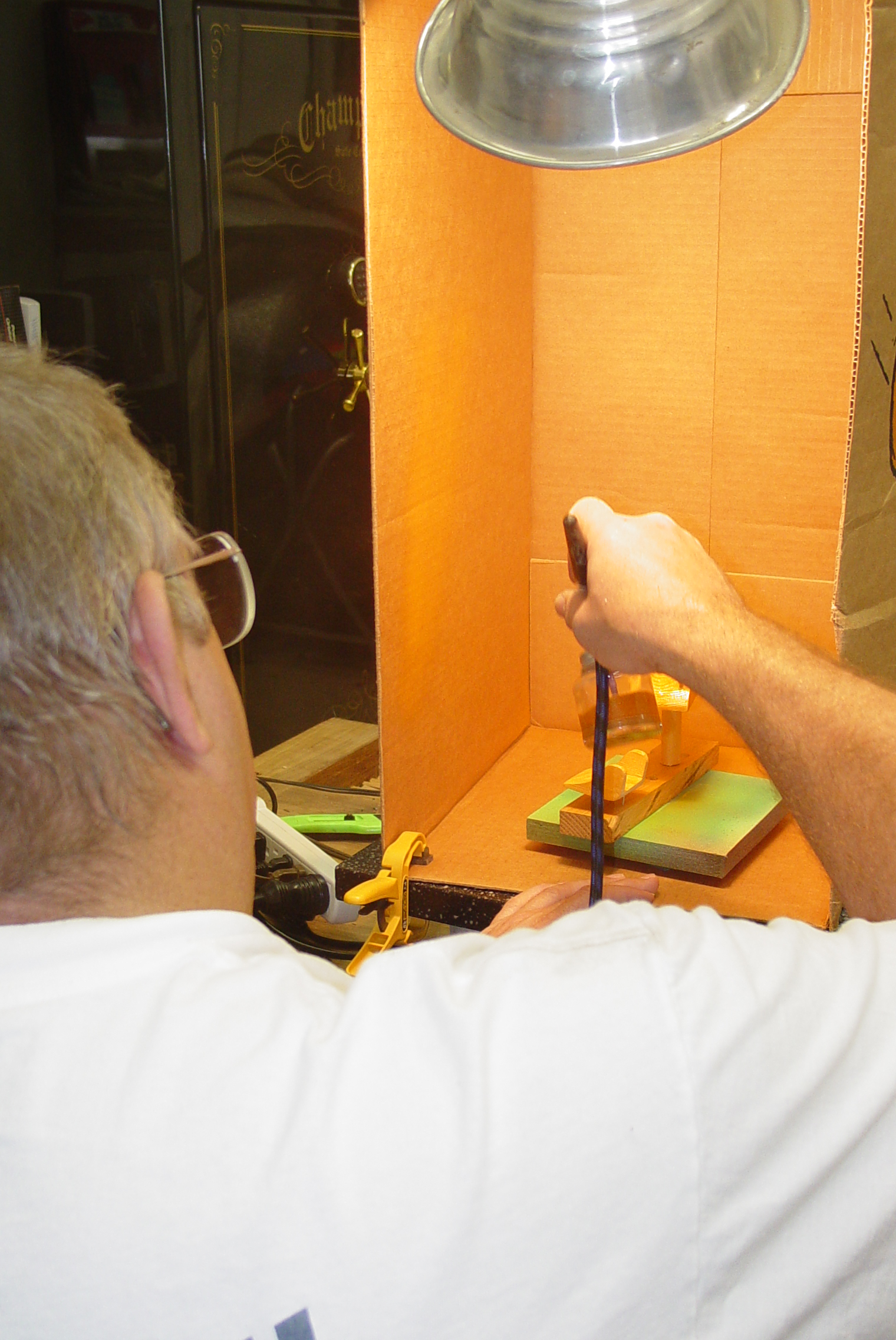

                          Here is the Large cardboard box version
