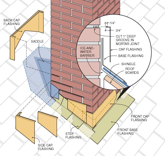

                I guess I am still not getting it. I have problems thinking in 3-D. Supposing the skylight is 24" wide. I cut a piece of flashing that is 36" wide and fold it in half lengthwise. Then I cut the horizontal side of the fold 6" from each end so I can fold it around the skylight. When I wrap it around the top of the skylight, then it is possible for water to drip down at the corner and get under the step flashing, no? Even if I wrap counterflashing around the corner, it can still drip down at the corner, correct?
                Maybe I will go up on my roof and see how my chimneys are flashed.
                  Another way I've seen skylights done, as the ones on my house too, is adding another piece of metal Z flashing at the top. If the skylight were 24" wide the piece would be 28 or so. it helps to cover the top corners and divert water away from the sides. It's the last piece to go on.
