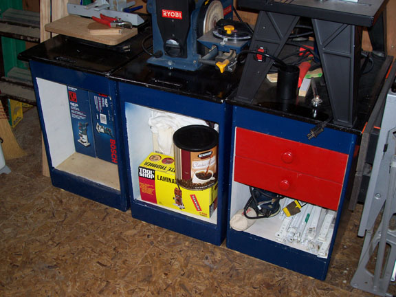

                    Originally posted by RAFlorida
                    I'm interested in your design. Sounds like a good idea I can use for my moveable support cart.
                    Here you go.
                    First pic is a detail of the wheels (2" wheels, 2-1/2" total height) and the bumpers (standard hardware store things).
                    Second pic is the detail showing the "built-in" handle (top is 3/4 Plywood, handle is made by drilling two 3/4" diameter holes 3" apart -- setback 1" from the front edge, and then using appropriate round-over bit to make it a "comfy" handle).
                    Third pic shows that the top of the "mini" Ryobi bandsaw table ends up perfectly level with the top of the BT3100 (unplanned by me -- it just worked out that way -- serendipity is occasionally friendly to me like that!). And yes, that's a Ryobi 10" Drill Press mounted on a "twin" base in the background.
                    Fourth pic shows several more "sibling" cabinets; in this case with the mortiser, belt/disc sander, and the old Ryobi Router Table which is also level with the BT3100 top (THAT one I *did* plan, as it was the "prototype" for the new tool base cabinets, only thing I changed was the original had sides/back made from 1/2 plywood, whereas all others have 3/4 plywood sides and back).

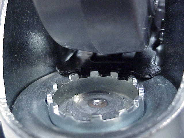

                        got an email from an albion dealer,
                        can get these for $6.25 a pop shipped.
                        the locking mechanism looks like it engages with 3 teeth and securely..
                        i ordered 12, and will go for 12 more if they work out...
                        heres a close-up of the wheel lock...

                            well they arrived today,i got them on 2 of the 3 fliptop stands now..
                            i was right about the foot-brake, it's a lot longer than typical ones,easier to hit. BIG plus !... these things lock down tight and rigid. i locked all 4 , shook the heII out of the tool stand, it wouldnt budge,and it's pretty light weight. they can also lock/unlock with mere "Finger Pressure" ,literally,its a nice "click"when engaged..
                            spun around very freely too.(of course the elec cord on floor stopped it dead,as with all my casters!)
                            have to say, i'm far too excited over locking swivel casters than anyone should ever be,LOL. these are really phenomenal compared to anything else i've had.
