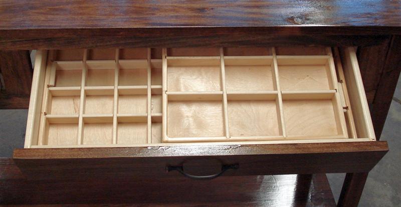

        Here's an example. Probably more elaborate than you will need, but you get the idea. These are 1/4 inch pine boards but I have also made dividers out of 1/4 inch MDF.
        Good luck, Steve

            I considered what you have done... but I'd like to be able to achieve "irregular" dividers - varying lengths and widths. I thought that I had seen a technique that used some kind of friction fit so the dividers were infinitely adjustable.
                        You don't have to use every slot. Here is a photo of "adjustable" partitions for a rock collection display box I mad for a grand kid.
                        Regards, Steve
