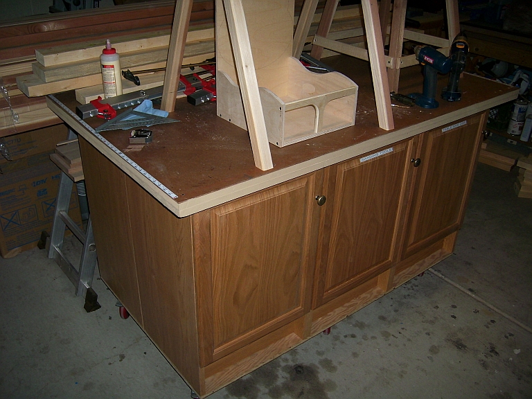

            My table
            Here's what I did. Found 6 small bathroom vanities at HD on clearance for $10 each. Mounted two groups of three side-by-side with screws and blind nuts. Mounted them back-to-back with pegboard between. Two tops of MDF and a covering of hardboard. One sheet of PLY underneath. Mounted six heavy duty swiveling casters with brakes. Works great, plenty big for assembly, right height, lots of storage space underneath, pegboard works great for hanging misc. stuff. Hope this picture works.
Name:	Assembly Table.jpg
            Jack
