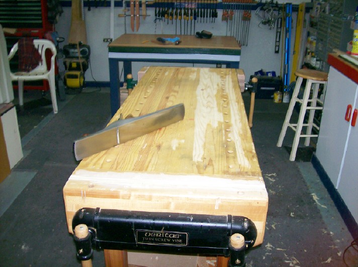

    Saturday I did my annual flattening of my work-bench top I built in a week-end early last October approximately. The top was not off with the exception of about ..030 rise (about spark plug gap) in basiclly two adjacent pieces of face glued stock 1 3/8" x 3" stock that was acclimated before I did the glue up.
    The flattening took about 7 minutes... 10-15 minutes to run a ROS with 100 grit over the entiere surface and tne another 10 to apply a new coat of natural Danish oil. The white or light colored areas show where the top has moved slightly nd the #7 jointer plane flattened. The SYP has pretty much case hardened at this point and is hard as a brick.
    So... anyone considering using SYP for a WB top... here is 4 seasons of movement. Summer heat of 85-90 degrees with rain and drought.. 30-45 degrees at night in winter with much humidity in Georgia.

      All the certified engineers were gone for the week-end so I used the "Southern back-yard shade tree" engineer method which in by no means deems the results scientific but... closer than "eye-ball" but not as close as high tech digital read-outs.
      I used trued phenolic winding sticks to locate high spots and penciled them on the top. Then I laid a Starrett 24" machined straight edge across the table from side to side to confirm high spots by looking for light under-neath while the edge was canted so just the tip where the bottom edge and top edge meet touched.
      Those gaps where light shone through between the high spots and remainder of the table were measured with a "feeler gauge". The distances varied at different spots but the largest feeler gauge blade I could slide under any spot was .030. Once planed there is no light showing on the follow up test using the machined straight edge.
      I would normally not use a feeler gauge but in this case I intentionally did as I decided to do a thread on several forums with whatever results I found. Again... not scientific and conditions will vary with weather conditions in various locals and various shops as there are no two idenical situations IMO.

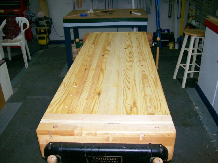

                          Have a good day as more woodem Xmas gifts are on the agenda tomorrow. I forgot to post a picture of the top after the quick over-haul I believe so will do so below.
