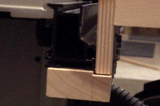

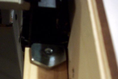

          Brain,
          Could you take some detailed pictures of how you attached the out feet table to the back rail of the bt3?
          Thanks a bundle!
          Regards,
          I just used the large T-nuts centered on a chunk of scrap that was wide enough to accomodate the 1/2" webbing of the plywood frame of the table.
          Brian
