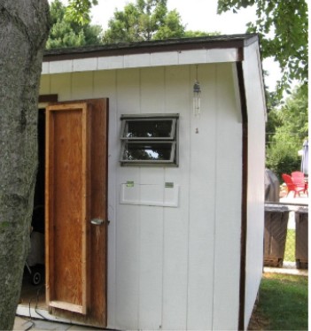

    To rip boards longer than a couple of feet it was necessary to first remove a step stool, a ladder, and the barbeque; then place boards in front of the door to the shed; then roll the saw out the door and down the incline. Then reverse the procedure when the ripping was finished.

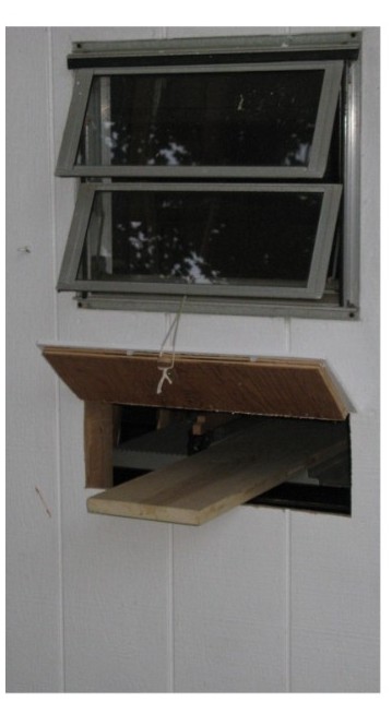

    The answer was to cut a hole in the wall of the shed below a window; save the cutout, add trim and hinges; then attach the cutout as a flap. A butterfly button on the inside keeps the flap closed and a bungee cord keeps it open when sawing.
    Now it is possible to rip 6-foot boards without moving the saw. A roller stand placed outside the shed catches the board as it moves through the opening.

    Good that your saw backs up to an outside wall. And, it must be warm there.
    Seems to me though that you have the perfect argument for a bigger shop.
    Regards, Steve.
      Excellent solution.

        When I had to rip a bunch of 12ft boards, I set my saw up on bricks, a couple layers high, until the saw table top was at the height of my basement window sills. The rear 3 ft of the boards stuck out the window, and as I fed the board thru the sawblade I had the wife guide the front end out the opposite window.

          You might want to think about a good outfeed table outside of the building
          to catch the cut-off portion as it exits the saw and the outside wall, to keep it from falling to the ground. eezlock

            Great thinking on the wall flap.
            I see shelving space in that door frame. A couple of one by 3's some 1/8 slats and some finishing nails and you have narrow shelves for storage of small items.

              A stroke of creativity. A cool solution and a cool shed. You should post a warning sign on the outside: "CAUTION-WOOD COMING THRU!".

                Good idea. You could build a hinged outfeed table outside under your flap that folds down when not in use with a hinged leg for support when needed.
