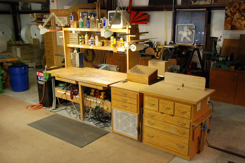

            Nothing wrong with on the floor
            Long before there were purchased air cleaners you had to build your own. Mine is nearly 20 years old. Before the filter I would be working in a cloud of dust from sanding and routing. Once the filter was made it was easy to watch the air being sucked into the filter - and the air you breathed was no longer in a fog. Mine was built to work as an extension to my workbench. The 1/4 hp motor drives the fan squirrel almost silently. One of the best shop items ever built. I added three drawers above the filter to make the box more useful.
