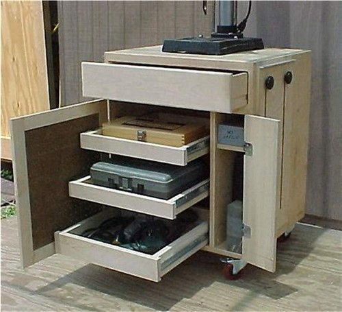

          I would keep it mobile cabinet mounted. Set the cabinet up for storage of drill related items.
Name:	DP Storage.JPG
          As soon as you hard mount it to the bench, it will get in the way!

              I agree with Pappy about mounting it on rolling base that can also be used for storage. I had my DP350 mounted to a piece of plywood sub-base which was then bolted to the workbench for a while. It seemed like it was always in the way of work on the bench, or the wall near the bench prevented me from being able to drill some item. I would sometimes unbolt the sub-base and move it, but that darn DP is heavy, so there had to be a real motivation to move it.
              I moved it to a mobile stand with some storage, and it was a great addition. Now the bench is open (except the junk that everybody thinks should stop right there). I can also get the DP out where I want it with no problem.
              By the way, Pappy, that is a great stand - lots of orgranized storage.

                Pappy, that's a very nice cabinet.
