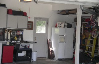

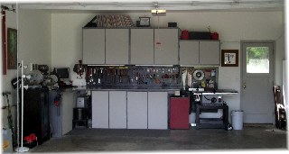

Front View

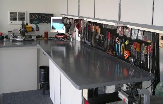

Bench Close-up

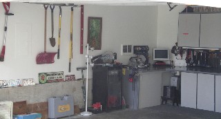

LHS View
RHS VIew

Front View
Bench Close-up
LHS View
RHS VIew
