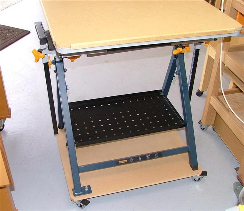

    Where it all comes together:
    The Ryobi one on the left was on sale at our last WW Show - about US$30 Didn't need it but couldn't pass it up
    My base (needed to be moveable), and top (don't like bare metal surfaces -other than the Table saw).

    The one on the right is from ShopNotes #30. VERY useful - the height adjustment makes it very versatile - has even been used for Quilting activities - at reasonable rental rates of course Worth the 4 days it took to build. 95% 3/4" MDF - so there!
      Where do you get most of your ideas for jigs, tables, cabinets, etc?
      I made the top for this because it doesn't get much use - but great when needed! An Oz badged JET I think (?).
      It's a what??!!
      The blue donut is my version of a DC adapter (MDF of course! laminated 2 x 3/4").
      Can I get a better look at it? How well does it work?

        Ric:
        Ideas? From "everywhere" the Forum, books, magazines, WW Shows, and some just seem to pop into my head I've commented before - I seem to be lucky enough to be able to imagine things in 3D, so there often a big gap between the "idea" and the real thing - think time.
        The other big source is "necessity". If I need to do something more than once, or, something needs to be "spot-on" accurate; I'll make a jig! Some jigs last for "the job", others get painted and hang on the wall
        Oz badged JET: I buy my (heavy) power tools from an Oz company called Carba-tek This OSS has their badge on it. It looks identical to the JET (USA?) brand.
        DC adapter - works perfectly - pic to come...

          Wow...that adjustable assembly table is incredible Rod! Being adjustable, are you sacrificing much stability?

                Rod,
                You sent me a copy of the plans a while back and I now need to consider a combination assembly/outfeed table to go with my new saw. Like Gary, I'd be interested in knowing how stable your assembly table is. I'd also be interested in opinions on using 3/4" plywood instead of MDF. I don't have great dust collection in my shop and it just seems like machining MDF creates a lot more really fine dust compared with wood. I probably have enough 3.4" ply cutoffs to make all parts except the top and leaves.

                  Rod,
                  Hmmmmmmm...
                  Stability? I wouldn't try a running jump onto it, but, having said that; all that MDF has a lot of weight. The 4 inner supports ("laminated" 2 x 3/4 - with the holes), are VERY strong. And the top is VERY heavy. As well, I made sure the outer supports are only about 1/32" larger all around to minimize "slop".
                  I move it around a fair bit and there is no discernable racking or sideways movement. I think it would be fine as an outfeed table - locking castors essential.
                  Plywood? You would get the strength without the weight. I guess it should still be OK.
                  I'm sounding hesitant because this is the first time I've "felt" that MDF is the "right" material for this item.
                  Let's see what others think...
