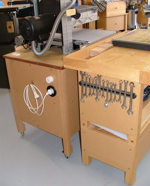

    BTW Wherever you see cabinets wired, the black receptacle is Power-in (from an extension lead). The white socket is to plug in the Shopvac. It gives me a single on/off switch to both the tool and the Shopvac.

        Did you wire your recepticles to work with your shop vac? Can you share some how-tos and what you used to do this? Woodcraft has a duel plug on sale for $20 for this purpose. I believe the shovac will come on when the tool is turned on and stay on for 7 seconds. That can add up for each station quickly.

          I'm interested to hear Rod's answer too, however I can tell you how I handled this problem in my small shop. I have the Sears switch which does the same thing. I plug this switch into the wall socket(middle of back wall) then a heavy extension cord into the main plug on the switch then the dust collector into one of the controled sockets. With this setup any tool that I plug into the extension cord will control the dust collection. Of course I have a small shop and 10' extension cord will reach any of my tools.
          This is a link to an article on how to set this up, I just changed the setup so that the Sears switch plugs into the wall socket then the power cord into the switch. It works well for me.

            I assume that outboard support on the sander is to prevent deflection? Were you having issues without it?
              Rod, I will also add my appreciation for you shop tour. Thanks.
              I'm always interested in ideas for making things co-planar. How did you get your drum sander and assembly table on the same plane?

                  DonHo: I simply wire both the Tool and another socket (white), to the power input (black); controlled by a single switch.
                  bthere: No real issues - It's for when I need to sand something wide - it makes me feel better that its there
                  JR: I planned it that way (I built the WDS base)
