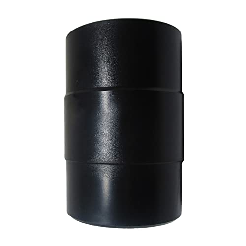

            This is what I use ...
            It is a DC hose-to-hose union. I slip one end into the hose and the other INTO 4" sewer & drain PVC. Available at Woodcraft, Rockler, Amazon, Delta, etc. I use spring clamps to secure the hose. (re: price -- I bought a bunch on close out at Lowes a few years ago for ~$1.50 each)
            I have a 1hp DC, so my shop is not plumbed with PVC. I connect only one tool at a time. I made uniform outlets for each tool from PVC. I press-fit the DC union into the PVC outlet, then disconnect to move to another machine.
