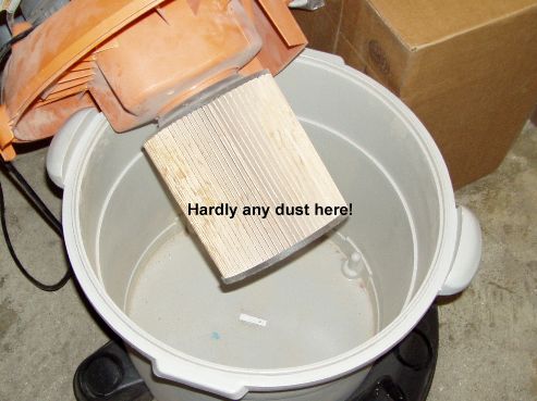

    I took the plunge to get one of these 2 days ago. It looked like it operated quite well in their video... I think it's been discussed here with not all agreeing on it's price/performance benefits ($165 shipped). But the price wasn't out of my range and I liked the clear view it gives.
    I carried the "clear view" idea an extra step and hooked it up to a cheap Wal-Mart clear trash bucket (Sterilite 24 qt) with clear trash bag liner. Below are some pics of early experience. I cut some MDF on the bandsaw and swept the floor for a test run. I was pleased with the early results - glad I spent the money.
    The amount of vacuum with this Rigid 6.5 HP vac is enough to partially collapse the bucket walls. See last pic where I added a stiffening ring (10-3/4" dia) to help this. I'll have to stiffen the lid also since it too collapses a bit when the vac pulls hard... but it works even without stiffening so far.

        Neat!
        How clean was the shop vac and its filter before you used the cylone?

              I just cleaned the filter and the vac canister fairly well before this test so I could see how much dust was reaching it after the cyclone. Not much is getting through - although tapping the filter did raise some fine dust, probably the sub-5 micron stuff the cyclone doesn't catch.
              I wonder if this is how the Dyson home vacuum works to keep from clogging - maybe a bunch of little cyclones? :-) If Dyson can do it, why not Shop-Vacs?
              BTW, I did more testing last evening - planed several rough sawn boards smooth to make a lot of sawdust... the cyclone really works - what a pleasure to take off the lids of both devices and see virtually no dust in the vac. Good-bye to cleaning the filter so often! Can't wait to plumb the shop so I don't have to drag this rig around.
