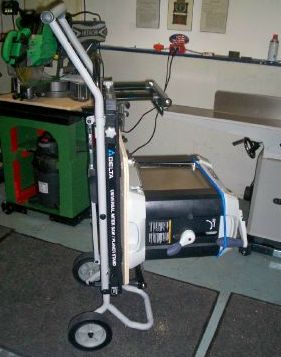

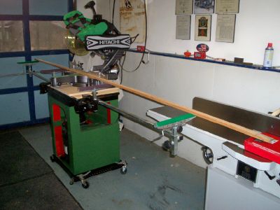

                    Here's a coupe of ideas... my SCMS base is home-made and with a Wolfcraft extention (de-mounted from legs) secured to the top. The extentions are sturdier than the Ridgid I looked at and will extend to 10'. With over-hang of stock it gives you 16' cross-cut capability supported. Closed the whole shooting match is 4'.
                    The Ridgid stand would work find and Delta makes one that folds up and stores vertical. When folded.. it is a hand truck to speak.

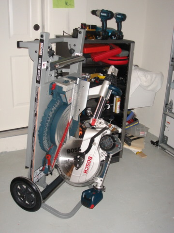

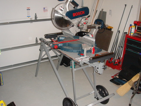

                      Just picked up the MSUV & mounted my SCMS on it last night....loving it!! What a great design. I thought it might be too much hassle to deal with setup & breakdown that it would keep me from using it as frequently, but I now see its a handle pull, then a squeeze and it's set up (unless I go full extension on the roller wings. Thanks for the great advice guys!

                        Nice set up Gary. I have the exact same saw and MSUV. I noticed that the extension tables were hard to pull out when the saw was directly mounted on the MSUV so I added 1/8 inch masonite shims under each of the 4 feet of the saw and now there are no problems.

                          Ryan - interesting. So far, mine seems to clear OK, but good idea if I run into trouble.

                            make sure that the table clicks in and locks when it is up and down. it is doesn't lock in the down position the whole thing will flip over when you tip it up to roll it.
