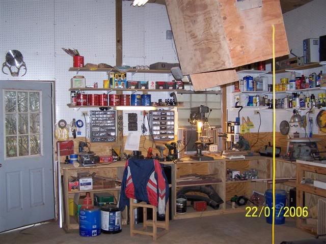

                          I did about the same thing in my pole barn. I added studs to the walls and rafters to the ceilings, insulated and then put plywood and peg board on the walls. Before and after pics.
