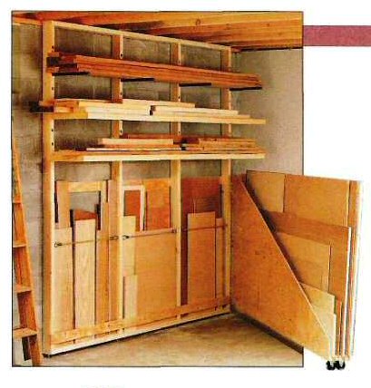

        Inspired by a reader's idea in Wood or American Woodworker, I built a storage system as follows:
        An "L" shaped 2x6, where the bottom is about 8 feet long, the riser a bit less than 4 feet. 3/4" plywood on both faces, all cut from one piece of 4x8, where the front has more of the stored plywood exposed. The riser is "hinged" on a pipe attached to the wall, so that it can be rotated out from the wall for access to the plywood. (The bottom 2x6 has wheels).
        I've got so many scraps and not-yet-used pieces of plywood in there that nothing warps - it is all held firmly!

            [QUOTE=Slik Geek;250588]Inspired by a reader's idea in Wood or American Woodworker, I built a storage system as follows:
            QUOTE]
            I've seen this system in Shop Notes No. 17. it includes board storage above the ply's 4' line and cut off storage behind the sheet storage (which is why it's on wheels and pivots).
            Looked like a great idea.
            Eric

              anyone got a picture ?
              ...mikel
                      ...mikel
                      I think this is what they are talking about.
