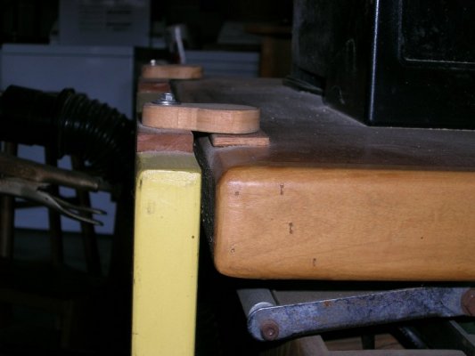

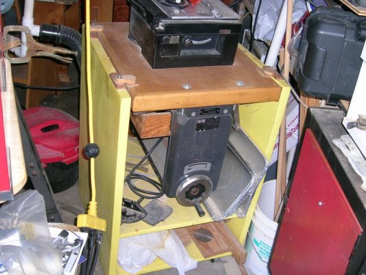

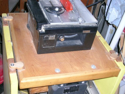

    I 'think' I remember the stand you are thinking about. I made one for myself years ago for my planer and a small hobby type circular saw. Here are some pics of what i made.
    The top is 2" thick. The sides are 1 1/4" thick. The pivot is a solid rod. The mid and bottom shelves are 1/2 inch ply. The Swivel Stops at the four corners are to keep the top in place. The stand is mounted on 1 1/2 in wheels, two are swiveling. If I had to do it over, I'd use 2" or maybe 3" wheels. The 1 1/2" get hung up on the tiniest bit of trash on the floor. Having only two wheel that swivel makes getting the stand out of the tight place I park it a real pain in the rear.
