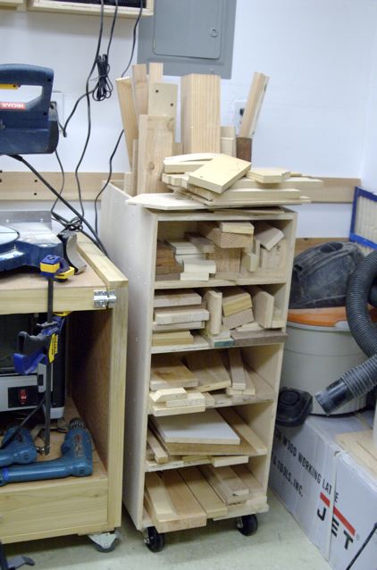

    I'm a little shy about showing what I've built for my shop because I don't think they're ever good enough compared to what others have done. But I know that shop storage is a big deal here, and I thought I'd share my latest small-shop project.

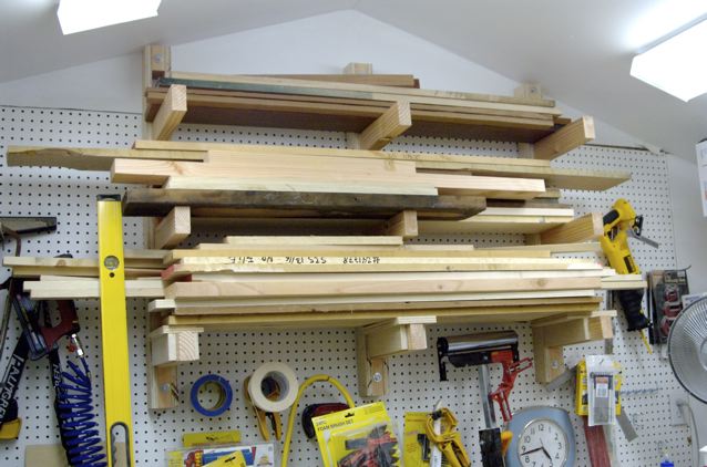

    I spent about three days building these. They were from one of the Wood issues (can't remember which right now). My shop is so small that I had to get the lumber I have off the floor, including three boxes of scraps.
    The lumber rack is about 12" deep, and there are about two layers of 6"-wide lumber on each of the bottom racks. It's fairly strong. Before I loaded it up, I performed my customary unscientific strength test, this time by hanging on the rack as a point load. I figured if it can carry 110 lbs of concentrated weight, it should be fine with a distributed load.
    The scrap sorter is supposed to have hardwood edging, but I was too tired and lazy to add that. Besides, it serves it purpose. The top shelf is 6.75" deep, the next one is 8.75" deep, and so on, until the bottom one at 14.75" deep. The back is great for longer scraps that are too short for the lumber rack.

        Looking great, Anna. I especially like the scrap sorter - makes sense of the small stuff.

          Never second guess your work. Looks great to me! Musta missed that small piece sorter. Looks good. But I'd need one at least 10 times bigger being the pack rat I am!

            Thanks for the great idea for the scrap rack Anna. Very nicely done!

                Did you hang the lumber rack onto the peg-board itself, or nail it to the wall thru the pegboard?

                    Looks great to me. Any way of getting materials off the floor in some uniform way is the way to go. Those high, unused areas are out of the way and make good storage areas. Just remember that warmer air rises.
                    Stacking up weight on a wall, especially high, should be VERY secure. You don't want that stuff falling on your head. That could be a real surprise. I've had high areas that require care to load and unload lumber. If you use a ladder or something like that extra care should be taken for your safety.

                      Nothing to be shy about, Anna. Both projects are functional and the cut off bin looks nice, too. The hardwood edging will actually strengthen the shelves. You can always add it later if you decide you need it. With a short span it shouldn't be necessary.

                          I thought the scrap sorter was a great idea, too, and, since I had not seen it posted here, I thought it worthwhile to share. Without the casters, it's less than 37" high. I'm sure it can be made as wide and as tall as you'd like, but this suffices in my small shop.
                          The wall rack design was decided on before the woodnet thread where everyone decided to buy the brackets and standards from Hartville or Lee Valley. I thought that if mine didn't work out, I can always buy the hardware later anyway.
                          The lumber rack pieces (including the arms) were made from 2 by 4 Douglas Fir and were all cut at an angle of 5 degrees so that they're sloping towards the wall. They're also attached to the studs with 5" lag bolts (four for each upright). The 3/4" plywood that sandwiches the Douglas Fir components in the uprights have four screws each holding them, in addition to glue.
                          I want to make sure they stay up since I have a vested interest in not having a ton of wood fall on top of my head. I'm playing with the idea of wrapping straps around them, but for now, it seems like they're staying put (I keep listening for a resounding crash in the middle of the night, though, just in case).

                              I like it, Anna! I have very limited space, too. A few days ago, I bolted 2 - 2X4s to the floor joists above my basement workbench. Added 4 arms, and loaded it with lumber. It functions very much like yours. But I don't have a cutoff bin. Now maybe I'll put that on my list of "To do's". Thanks for sharing.
