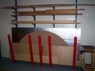

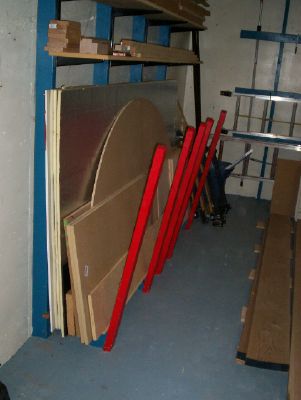

                      If you don't want to drill holes in the center Ken, why don't you just tie into the joist above and run your studs verically to the floor. You can even put a platform down for sheet goods. The studs won't go anywhere if tied and en-forced to those joists as the floor end of the stud is supporting all the weight.
                      You can drill pre-holes in the studs for 3/4" pipe or add shelf brackets as I did on mine for adjustability. The selves are that slick coated whatever that cheap stuff is called. MDF will work. Just space the studs close enough to that there is no sag. If ya use the pipe.. be sure to give about a 5-7 degree lift at the front to avoid any chance of major vibration causing the stock to come off before you dicide it's time to come off. ha.. ha...
