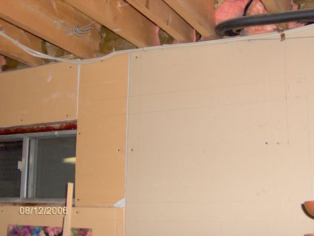

          Originally posted by backpacker85
          You don't mention what type of ceiling this area has, so it may not be an option, but.....the best way may be to hang vertical braces from the sides of the ceiling joists. Just a thought.
          This is an unfinished basement and the ceiling joists are exposed:
          I had not thought about this option but I will look into it. As you said it may be the best way to do it.
          Turaj (in Toronto)

              What about standing sheets of plywood floor to ceiling. screw to horizontal furring strips, then screw your cleats to the plywood.
              Eddy
                Hard to tell from the picture, but it looks like the dry wall is put up with screws. If it is, it will be fairly easy to remove a sheet so you know what you have to work with.
                  hang your cleats on vertical supports down from the ceiling. If you run blocking that spans the joists you can screw vertical pieces of ply to that through its face and keep the cabinets much closer to the wall that way.
                  On second thought I think I'd hang the vertical supports from the sill plate.

                    Pappy, ufortunately the drywall is not screwed in, but regardless I am going to take off some portion to see how those furring strips are attached.
                    Eddy, I have often thought about redoing the basement! Taking off everything. put vertical strips and cover with plywood! Unfortunately it is much bigger project that I want to handle at this time (I may still do it - little portion at a time).
                    David, that is one that I want to check. I like to keep the cabinet closer to the wall. I am not too concern about the downward force as much as I am concern about tipping it over!
                    I'll see what happens. I'll post some pictures when I finish the cabinets! Thanks again.
