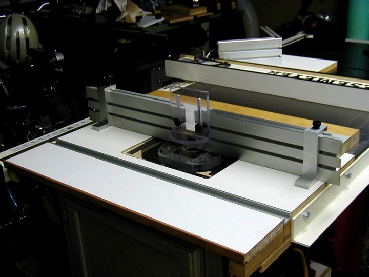

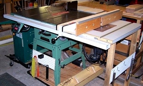

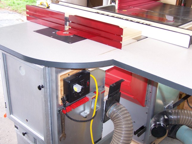

    I've built 3 that I've mounted in the right wing of my TS. The plusses are obviously cost, but you can also build in the features you want. I've always managed to use a piece of laminate that was either in the shop or that I found discard along the road. Melamine and MDF of this size isn't too expensive. The t-tracks should only run about $25 total if you buy alot. The fence can be as simple as a flat straight board with a bit opening, but most of us prefer a bit more function.
    My tables have been fairly simple,b ut I doubt I've ever spent more than $40 on one. If you're talking about something more elaborate like Norm's RT, it'd likely run a bit more, but should still cost less than buying.
    There's a pic of all 3 that I've built.

        Dustmight, do you happen to have more photos of your third set up? Looks like tricked out 22124. I have phenolic table from CMT mounted in the right wing of mine and I need to add something to the bottom like you have for support and DC. Can you post, PM or email me photos of the RT set up along with the over all view of your TS set up?
        Thanks if you can! If you can't no problem.
