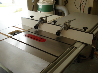

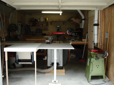

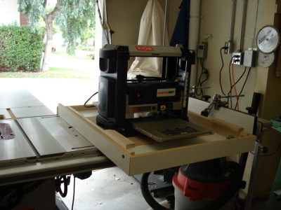

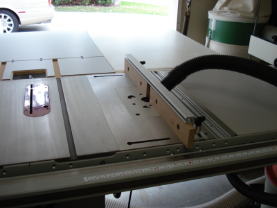

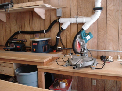

    I finally finished my shop upgrade. My sanctuary is housed in a one car garage which is adjacent to our two car garage but seperated by a wall. When I originally designed this I layed it out to utilize the space as best I could without having to move things around. The layout is working quite nicely and I thought I might share some pictures. The most recent addition is the Unisaw. I added the second outfeed table which is hinged to the extension table. Mounted underneath is my thickness planer which can be flipped up onto the extension table when in use. I also upgraded the DC with the Creative Dust Control system. When it works it is great but I have had many difficulties with the automatic blast gates. Three out of five are not working or working intermittently.

    Sweet Shop. You must be taking lessons from Rod Kirby - no sawdust.
    "I'm growing older but not up." Jimmy Buffett
      That is one nice shop! I like the dust collection piping. Looks very professional.

                          Excelent shop Tom! I wanted to do something similar with my dust collection. How are the hoses conneced to the PVC?

                            Excellent layout on your DC ports, Tom.
                            I'll probably use a modified version in my own Shop. As near as I can figure, I'll need about 12 ports, split into two runs (one down each side of the Shop).

                              As far as the DC hose is concerned I managed to fit the flex hose into the coupling of the S&D pipe. It is a very tight fit which requires some coersion but once it is in it doesn't want to come loose. I also clamped the hoses to either the equipment port or the blast gates where appropriate. The S&D pipe works very well and is the most cost effective solution that I could find.
