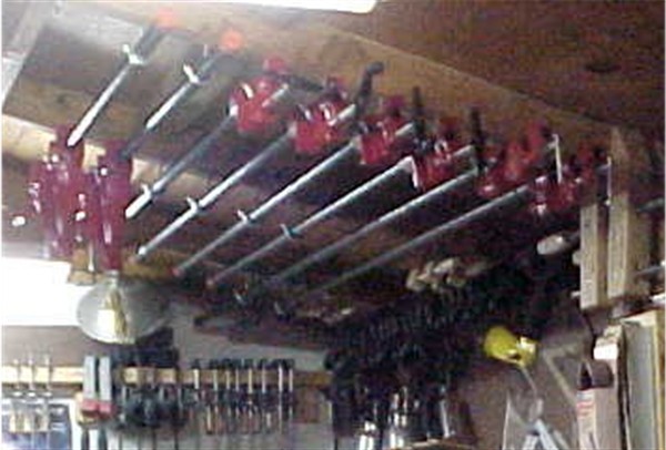

    Hmmm, I thought I at least had a bad picture of my pipe clamp rack.
    Here's the general idea: Start with a section of 2x4 that will be the length of the rack. Set it on edge. Take short pieces of 2x4 on edge, and butt them at right angle to the long one, at 1/2"+ spacing, forming the slots for clamp storage. You might want to make them 3/4"+ spacing for if/when you get 3/4" pipe clamps. The length of the short pieces is dictated by how many clamps you want to "stack" in each slot. You'll be limited by the strength of these arms.
    On my rack, I chose to only have one clamp per slot, but wish I had at least made it to hold 2.
    Regards,
      Eye hooks. These had to be bent out enought to hold 3/4 pipe. If your ceiling is too high, hang the rack from the ceiling joists.
