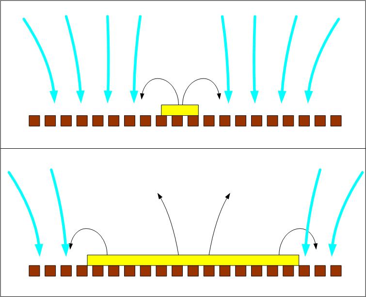

    Their efficacy (word of the day) largely depends on size of parts vs. size of table and airflow. In general, I think you still need to use the DC port of your sander, especially for the larger parts.
    The first pane of the diagram below shows how the dust from smaller parts will be influenced by the downdraft airflow before they have a chance to escape. Sanding larger parts means there's more chance for dust to escape upwards before being influenced by the downdraft air flow.
Name:	DownDraft Table.jpg
    Seems to me that most of the dust that escapes from an ROS is from the ROS going over the edge of the workpiece. Here, the downdraft table will do a great job of collecting.
    I made a 2' x 4' downdraft table with a pegboard-top with holes enlarged to 3/8". It's in a 5 - 6" deep frame, and I have a 4" DC port attached to it. One of these days I'll have to try a smoke test to see how well it works, or rather, to gauge its efficacy (that's two -- eight more to go today).
