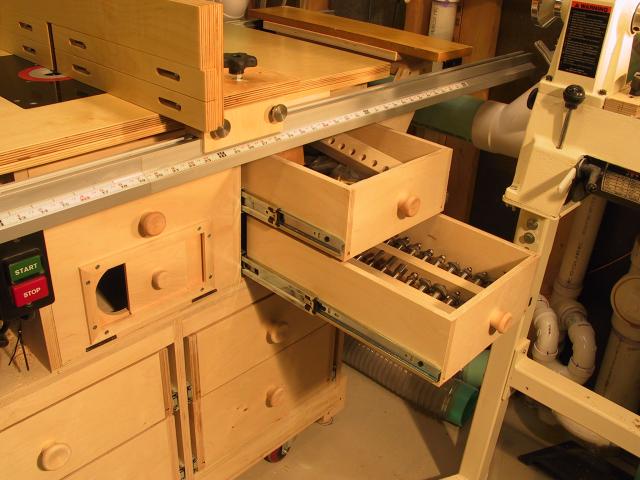

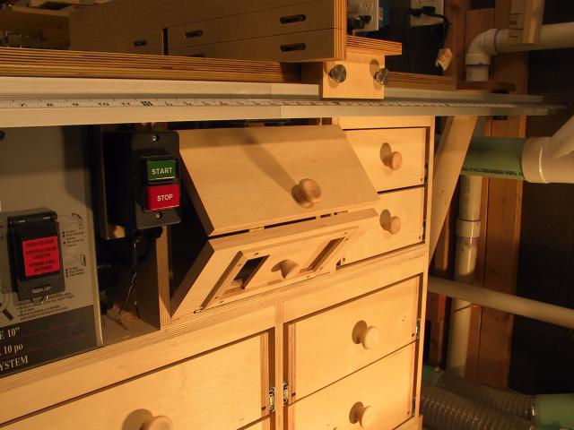

    In this shot you can see the sliding door for air intake (for DC) on the router compartment, with drawers next to it for bits, etc:
Name:	Router Comp Drawers.jpg

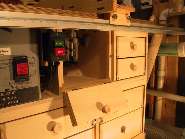

    The idea for the router compartment door just popped into my head one day -- so far it works really well in that it's out of the way when open. RE magnets hold it closed really well, too. (I used a piece of tape to hold it half-open for the picture, otherwise it's either fully open or fully closed.)
Name:	Router Door Half Open.jpg
Name:	Router Door Open.jpg

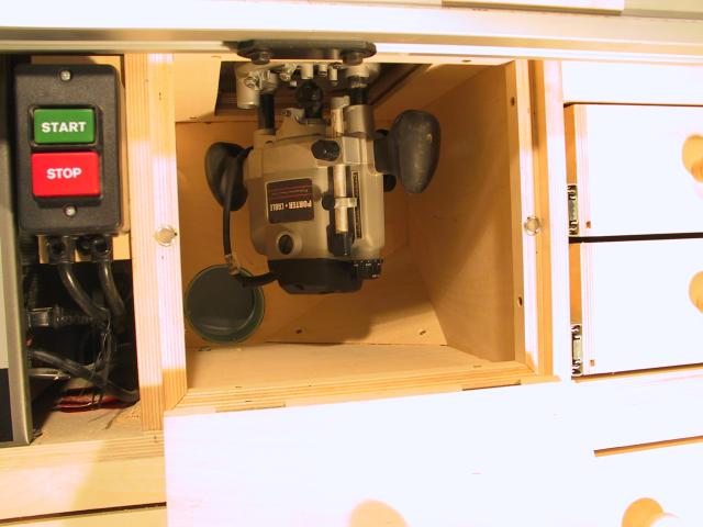

    The router is very accessible with the door open, meaning height adjustment from below is not much of a motivating factor for a new router plate:
Name:	Router Comp Inside.jpg

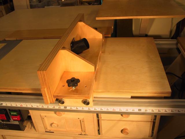

    For the router fence, I decided to try attaching to the BT3 rails. I figured I can always re-work it to clamp to the table top if I don't like it. So far, I think I like it.
    Here's the front of the fence (I'll probably add t-track to the front face, but maybe on top):
Name:	Router Fence Front.jpg

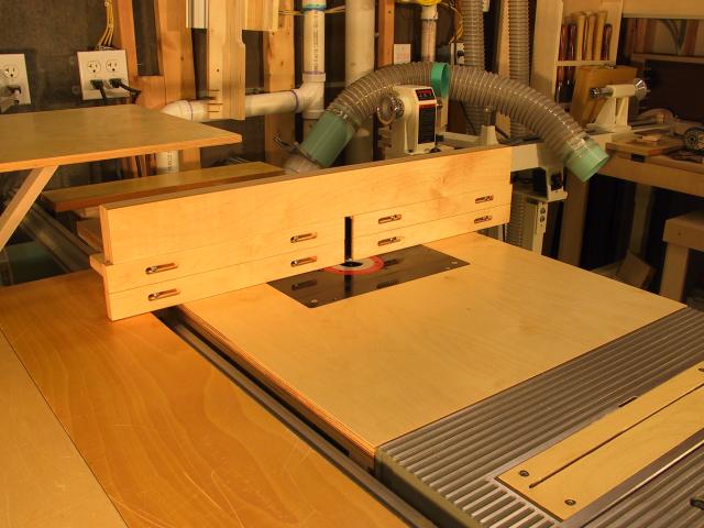

    ...and the back:
Name:	Router Fence Back.jpg

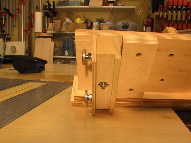

    It attaches to the front rail using a bolt into a t-nut. But I also added a front plate to keep it square to the rail. I figured this might allow me to use my rip fence micro-adjuster on the router fence.
Name:	Fence Front Clamp.jpg

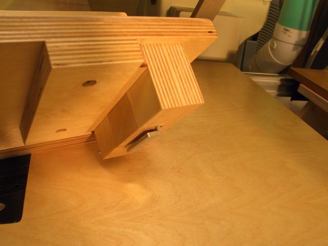

    The rear clamp is kind of the same idea as for the rip fence. It's based on a piece of Al angle that pulls the rear of the fence down to the rail:
Name:	Fence Rear Clamp.jpg
Name:	Fence Rear Clamp2.jpg

      Wow. Nice, Tom. Really nice. I have one question, and one suggestion.
      The Q: What are the two large-headed bolt thingies on the infeed side of the router fence? Are they part of the clamping mechanism, somehow ...???
      The S: My router fence is very similar. If you've not already done so, make up an alternate sliding fence section for the lower infeed side, with a 1/4" x 1/4" rabbet along the bottom edge. This will allow you to flush-trim edge strips on plywood panels.

                  Great ideas/execution. I like the bifold-door idea for the router. I have a couple of questions since I am thinking of upgrading my bt3/router setup.
                  Would you mind explaining what you are using for DC under the table. I see you have a 2.5 hose for fence collection. Do you have a dust port under the table too with a baffle or a a slanted back (looks like it from the picture).
                  I like the fence clamping brackets too. Do you have to clamp the front and back down seperately or does clamping the front bracket pull the rear bracket into the rail thus locking it down too? Is that what the Al angle is for? Really curious. Could you post an end-on shot of the rails with the brackets and fence in place? I'd like to blatantly steal your idea and a picture would make it so much easier
                  Great work!

                        Larry: The two knobs on front hold that 1/4" ply plate to the front clamp. When they're snugged up, it squares the front clamp to the rail. I figured that doing it like this, I could trade off "squareness" for "slide-ability". It's really not necessary, and the jury's out on its functionality.
                        There's a good reason your router fence is similar, BTW. That's where I got the idea for the double slider mechanism. Thanks for the suggestion, too. It hadn't really dawned on me yet, but now that I have removeable/replaceable sliders opens up a lot of possibilities.

                        jwaterdawg: In the 4th picture down, you can see a 4" port at the back of the router compartment on the left side. In back, I have 4" S&D, and 4" hose connecting DC plumbing from the saw, with separate blastgates for router and saw. I also attached a sloping piece of ply on the right rear corner inside the router compartment -- you can barely make it out in the pic.
                        The front and rear fence clamps operate separately -- nothing as fancy as the BT3 rip fence. I might switch from knobs to cam clamps, though. I can post another pic or two showing clamp details, along with the rear DC plumbing.
                        Thanks again for the coments, guys! And to Alan and Alex: just so you know, there was a dust-valanche shortly after I finished taking pics -- all that dust that I had to pile up out of the shot.
