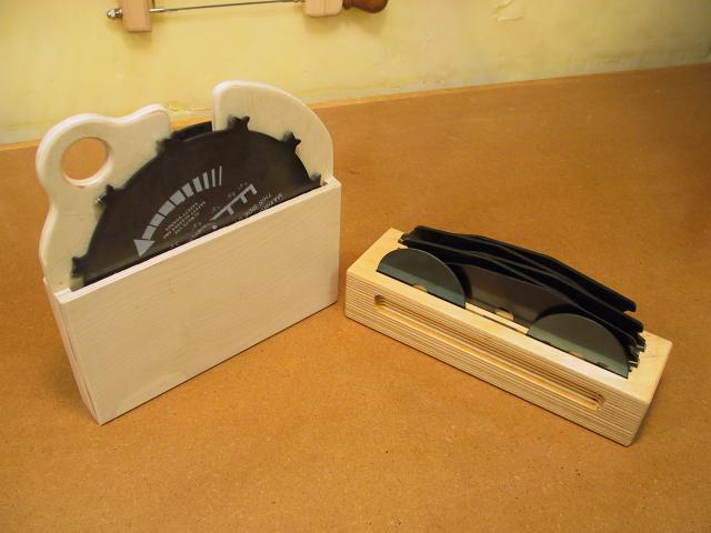

    Now that I have drawers under my BT3, I thought I'd make my dado blades a little more accessible. This was quick to make, and I've been a little surprised at how nice it is to have these blades a little more handy.
Name:	Dado Caddy.jpg

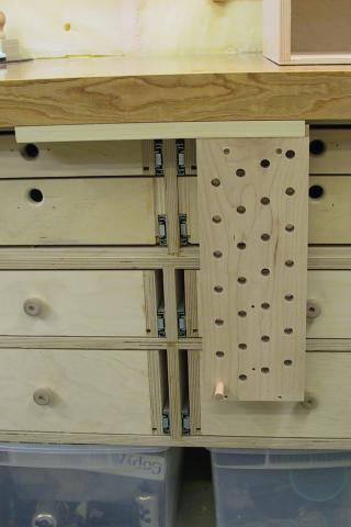

    Then, I thought I'd make my board jack a little quicker to install and remove, while being able to move it out of the way of the drawers while in use.

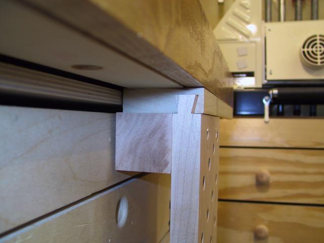

    It attaches with a sliding dovetail into a permanently mounted track. I made a couple 16" long tracks and spaced them out.
Name:	Board Jack Attachment.jpg

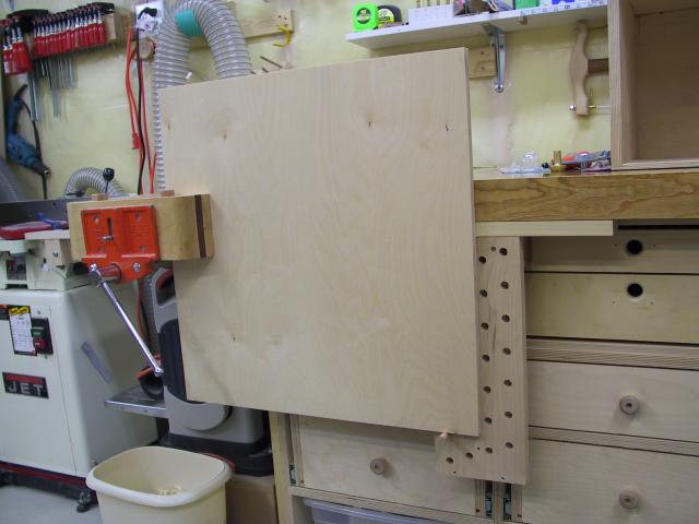

      I hate to sound dumb... again, but what is a board jack?
        Later,
        Chiz
        Oops, my fault. I should have shown it in action:
Name:	Board Jack in Use.jpg

              HeyTom, what's the vertical stagger of the rows, 1/4"? 1/2"?
              TIA,
              Chiz
              Blessings,
              Chiz
                    TIA,
                    Chiz
                    IIRC, the holes drop 1/2" as they step across. So, in the strictly vertical direction, they're 2" on center.
                    The holes themselves are 1/2" diameter.
                    Regards,
