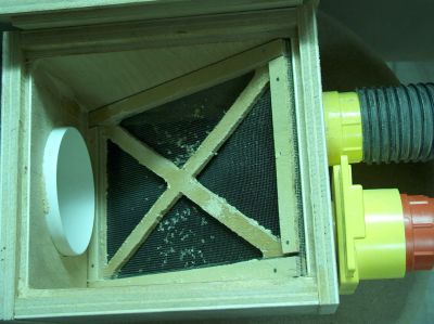

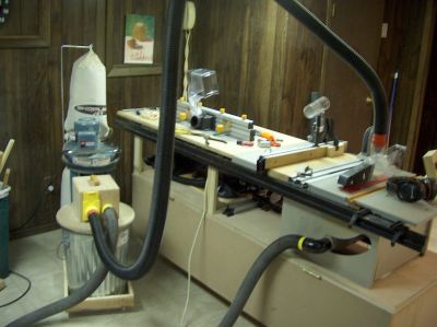

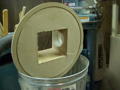

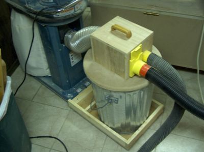

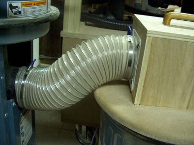

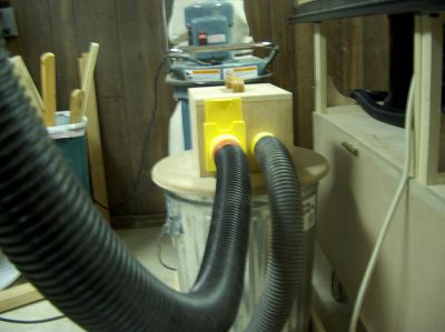

separator is in a lid on top of 10 gallon trash can. Separator is installed on a small cart and the cart is attached to DC, so the 2 roll together. Short run of 4" hose connects separator to DC, 2 shopvac hoses provide air intake. One hose connects directly, another through a blast gate. The core of separator is a filter in the lid. Filter is just a a plywood frame with a piece of mesh stretched on it. Mesh that I use against insects on my screen doors and windows. Filter is installed diagonally, this way air and small dust goes through mesh, bigger shavings and chips the filter knocks down to the can. Separator consumes very little air pressure. My first test was the standard one - empty out all the content of DC, install the separator and suck back the same junk. The result -about 85% of the junk stayed in the separator.
