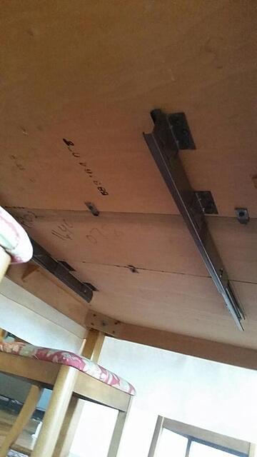

            Being a very practical family, we decided the table was in good shape, it already has matching chairs, so instead of making a brand new table, we'll just grow this one. It's got metal slides that do the job, but aren't long enough for this application: The table appears to be oak veneer over MDF.

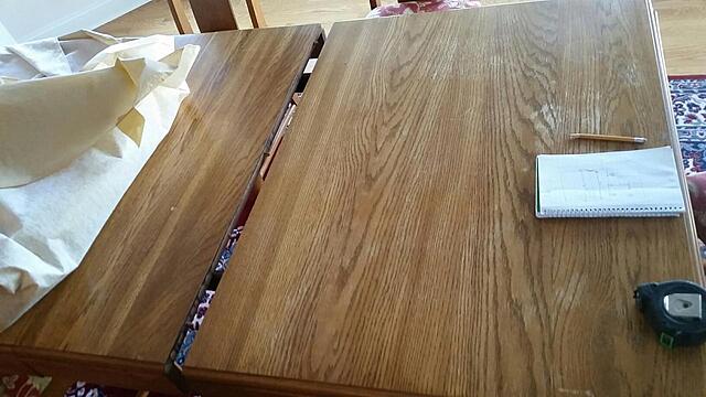

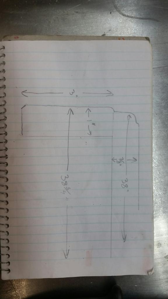

            I took some measurements when I was there last fall and also traced the profile of the leaf. I forgot to bring my profile gauge so my parents had to text me some better pics of the profile last night:

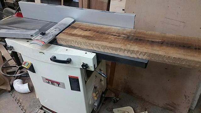

            Originally, I was going to resaw this hunk of oak in half and glue up a 20" wide top. I sure am glad to have a 12" wide jointer! However, there was a slight twist in the board so I couldn't slice out 7/8" thick boards (the thickness of their tabletop) after all the surfacing was done. This was fine because it would have made for some heavy leaves.

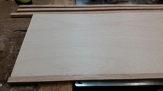

            So I switched to plan B and resawed sheets of veneer on my bandsaw. I had to make a better resaw fence for these tall boards and I installed a new blade. I definitely need to work on tuning the saw. I squeezed out 8 sheets that I drum sanded down to a thick 1/8". I glued on strips of oak banding to some 3/4" sandply. The sandply plus the veneer equaled a thick 7/8". Then I vacuum veneered the veneer onto the sandply. I've never cut my own veneer before or worked with veneer this thick. I've always used the 1/42" thin commercial veneers. At 1/8", it's definitely like working with "regular" wood. You can edge glue them, etc. Because my resawing wasn't the best, there were some divots in the veneer which I placed on the underside of the board. Since the bottom side was against the hard platen, some spots didn't stick to the substrate. Since I used Titebond 2, I pressed those spots with a hot iron and was able to reactivate the glue and press them down--mostly. There are still a few small "hollow" spots, but they're all on the bottom.

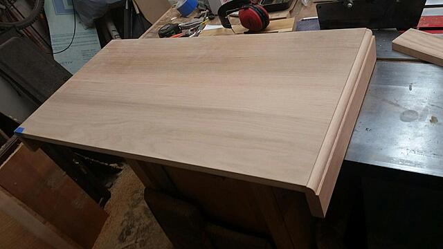

            I cut the boards to size (20x38), and then routed a matching profile on to them. The top veneer blends into the solid edging, but the bottom doesn't. Oh well. My Mom usually uses a tablecloth anyway.

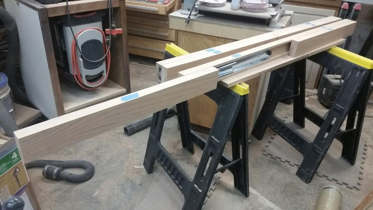

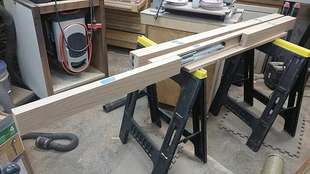

            I used the FWW article I linked above to make the drawer slides. Again, more 8/4 lumber I milled down to accept 2 heavy duty 22" 200lb drawer slides. When closed, the extenders are 56" long--long enough to accommodate the current 12" leaf full time and then will open up to accept the 2 new 20" leaves. Rockler sells heavy duty metal table slides for this opening size, but I read they were a little cheesy. I like the way these operate and look (although who's going to stick their head under the table to look?) At least I know I did the best I could.
