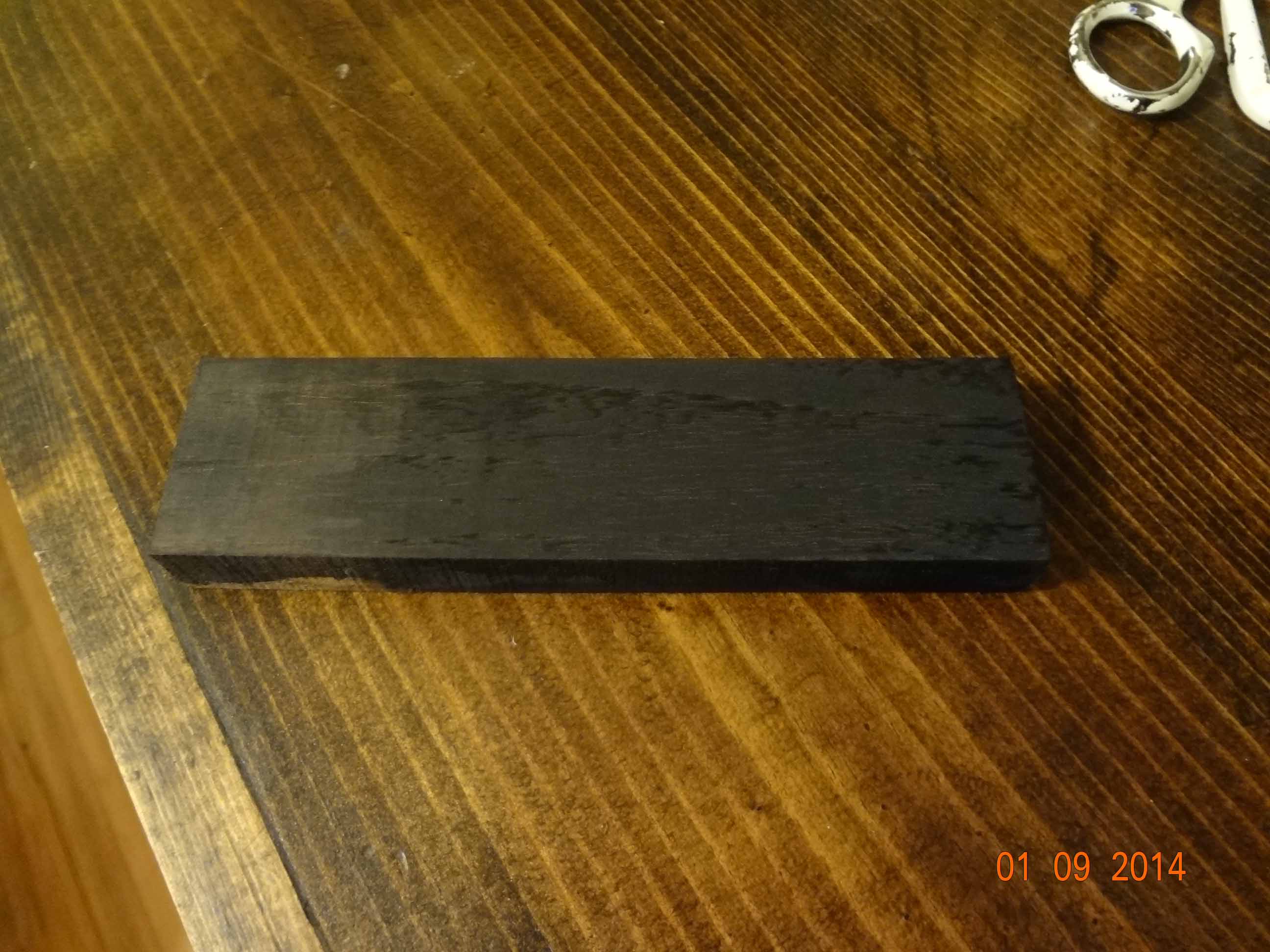

    I'm making some clocks and I need some ebonized wood for the accents. I found a recipe from Popular Woodworking for ebonizing wood and tried it out today. It works great. I've added a link to the instructions and where to purchase the "bark tea". FYI, it's not likely you will ever use up two pounds of this stuff in your lifetime.
    The picture shows a test piece of walnut that I used to test PW's ebonizing technique. At the very end of the wood on the left side is an area that I did not use the bark tea on. The rest of the piece of wood I did. I haven't yet done any finishing to the piece like waxing or anything else. This is the finish I got following PW's instructions. I am very, very happy with it. I plan to use to black shoe polish and buff it to a soft finish.

    I ebonized a wood bowl that I turned a few years ago and it turned out great. I really liked it. It gives a real deep luster to it too!
