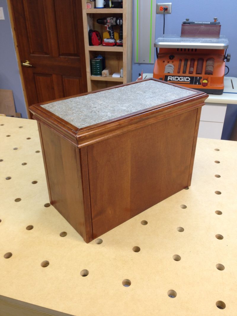

      Here is a picture of the cherry "dog bowl stand" (I know, what a waste of wood -- but my daughter got her first dog, and is spoiling it miserably ...)

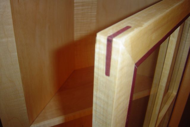

              I find that carpenter's glue provides all the strength you could want for a good fitting joint. That said, if you use biscuits, and they are somewhat loose, I'd go with epoxy. I think biscuits are best for alignment, and not for adding strength. But epoxy would fill the gaps and provide a strong bond.
              You might want to add splines instead. I built my daughter a corner china cabinet in maple, and used purpleheart for highlights. Here are splines in purpleheart. Of course, if you don't want the splines to stand out, you could certainly make them from the same wood as the picture frame.

                Thanks Bruce, for your very nice comments on the dog bowl stand I guess what I really meant was that it was a bit over the top for a dog bowl stand. But, my daughter likes it, and if she ever wanted, she could use it as a plant stand or something similar. Don't get me wrong, I am pretty proud of it. This was my first project using my new Festool track saw. It is the most accurate box I've ever built. Since the tile needed to fit well, I designed it starting with the tile dimensions, and calculated the box size, with offsets for the top cap trim. The box is within 1mm in all dimensions.
                The top is a piece of 8"x16" ceramic tile from Home Depot. It was the only one I found there, but it has a rough texture I like. I bought an extra for some other project that has not identified itself yet! The color that best describes it is "chocolate malt". Was cheap, too -- just a little over $2 each.
