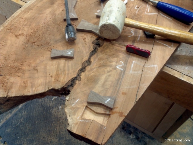

                    I was getting kitchen fatigue and wanted to move this slab out of my way and get it into use. I was stressing that the butterflies would need to be inlaid perfectly but close really is good enough. I roughly marked with chalk where I wanted the keys to go. I already had some walnut roughly planed down to 3/8" and just laid them out with pencil and cut them out with the BS. I'm not that great with the band saw so several swipes of the edges on sandpaper laid flat on my TS top got them straight.
                    Then I scribed around each key with a knife. I chucked up a 1/4" spiral bit in my trim router and set the depth to slightly less than the key and slowly cut away the waste. I also chucked up an 1/8" bit in my other trim router and routed even closer to the line. The 1/4" bit was super dull so it was slower than expected.

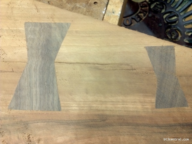

                    Using a sharp chisel set in the scribe line, I cut the key hole to the exact size checking the fit against the key. I put some glue on the bottom and edges of the key, laid a block on top and whacked it several times with a mallet to seat the key.
                    There were some noticeable gaps which I planned to shove cherry wedges into. However, when I sanded the keys flush with a belt sander, the fine dust filled the gaps and they look invisible to me. I've got a few more keys to inlay then I'll sand the whole slab and ponder how I will attach the base to the top.

                      Very nice bench, Paul.
                      Your fit on the butterfly is amazing.
