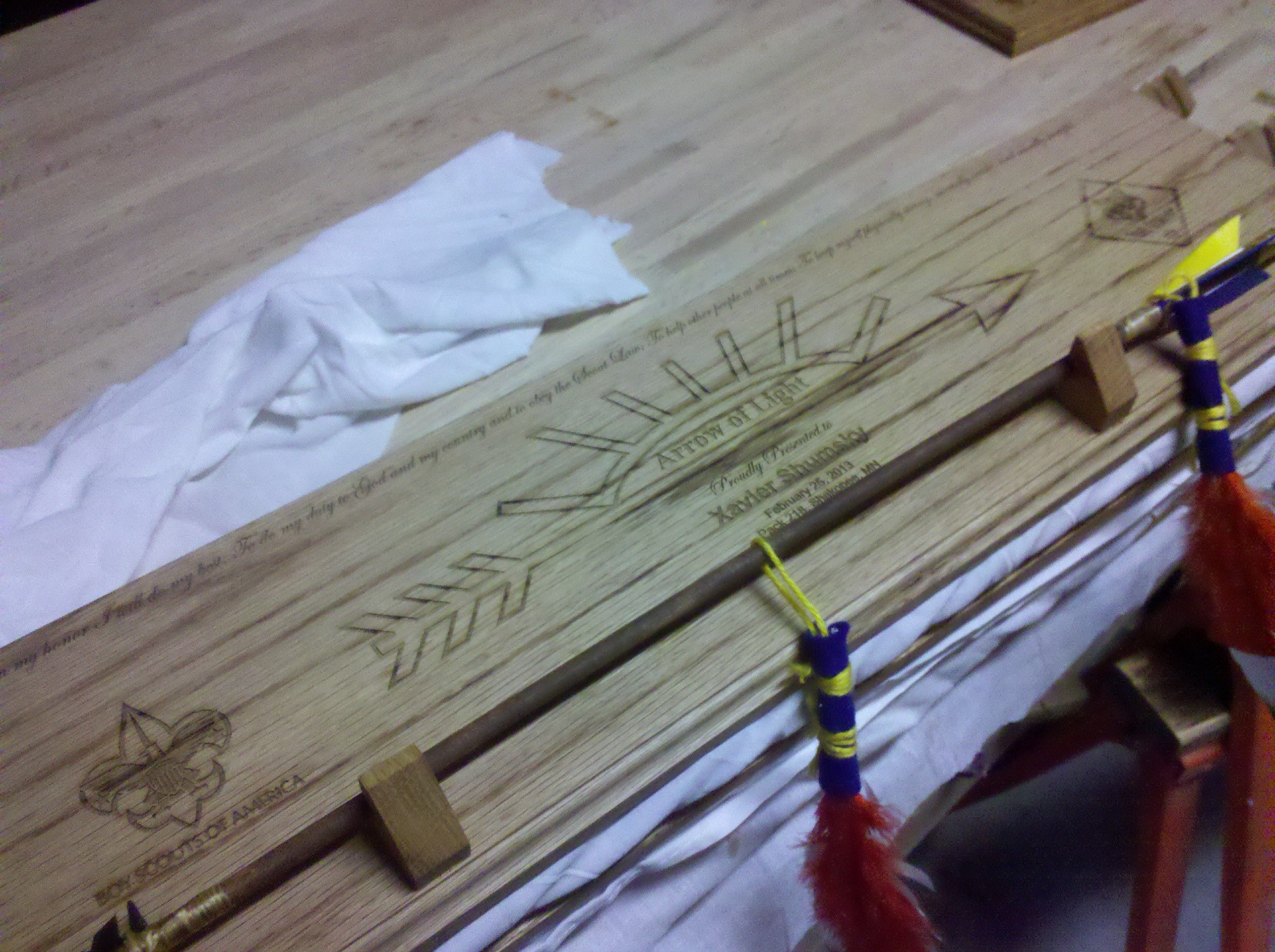

      Here are three pics... the first is a comparison of one that is readable, and one that is not - you can see it was due (I believe) to the different grain of those pieces of oak.

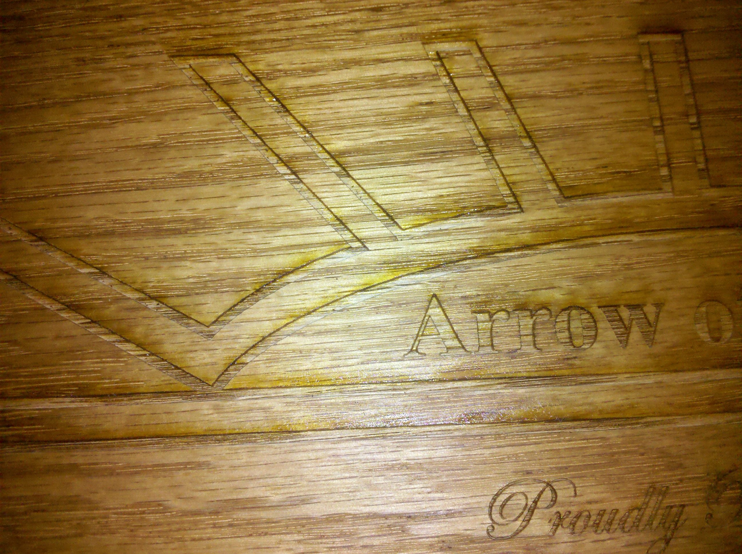

      The next is a closeup of the engraved area.
      The final is a "dry fit" of what the final project is going to be... although I'm going to make prettier arrow holders.
      I now see that I will need to do some sort of fix up, as some of the engravings have some areas around the engraving that have overheated and caused some weirdness in the stain.
