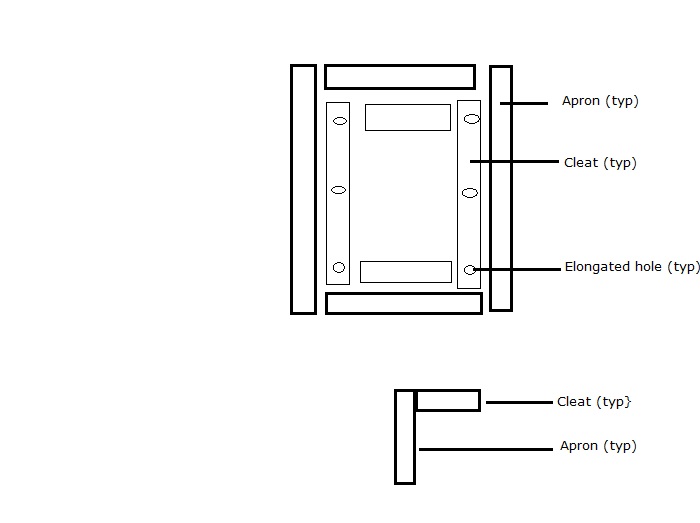

                    Originally posted by cwsmith
                    The place I use screws (if I can avoid it) is to fasten the top to the table apron, in a matter so it will float (expand and contract). I do also use screws for fastening drawer glides or channels... that way they can be adjusted or replaced.
                    Here's what I do...
                      My favorite way to attach a table top is to put a dado that ends about an inch down on the aprons. I cut scrap in a convenient size to have a little tenon to fit into the groove loosely and I screw it to the table top. The scrap piece is not bottomed out anywhere so the top can move. C'man's idea is at least as good but it requires a little larger scrap pieces for the cleats.
                        It also stiffens up the apron.
