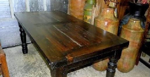

    I have been given the opportunity (read challenge/request) to build a dining room table for my daughter and son-in-law. They are building their first home (been renters for 11 years or so) and want a customized table to fit their new dining area.

    they have specifically noted that they don't want a "glossy" finish ... the table in this attached picture is "too glossy" for their taste.

    Normally I would defer to my standby hand wiped poly but I'm not sure I can get it "not glossy" enough ... even "satin" seems too much in this case.

    The distressing part should be really easy. Just don't do all the things you normally do in a project to protect the edges, corners and top from getting scratches, don't slavishly follow your sanding schedule, drop some heavy chains in places, dig into the top with a screwdriver or awl in some spots, intentionally sand through the finish in places before top coating, etc.
    As for top coat, being a table you do need a durable coating. Go with several layers of gloss poly for color depth and protection followed by a top coat of satin poly that you can further rub down to the desired sheen. That will give it the old world waxed look while still giving easily cared for protection.

      Finish sheens are scaled from 0 to 100 (its reflectivity). The lower the number, the duller the sheen. A finish rated around 5 degree is called a Dead Flat. A finish rated around 90 degree is called a Gloss. Look for a sheen degree to match your preference: Dead Flat, Flat, Satin, Semi-Gloss, or Gloss.

        +1. That would work. A suggestion would be to know which Cypress is available. Most common species aren't that hard. If it's Australian Cypress, that would be suitable.

          CM ... I'm sure the Cypress I will have access to is "Texas Swamp Cypress" since the mill I buy from gets all of their wood from Texas sources.
          As far as hardness ... it's something I really hadn't considered ... the several tables we looked at that they liked were typically reclaimed Long Leaf Pine, "Cypress" from Mexico, and occasionally some Alder. I'll try to get a better handle on it when I go to the mill.
