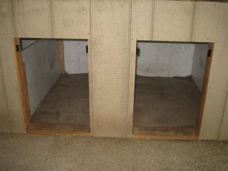

        They worked pretty well for some plexiglass dog doors I did yesterday too. I made the pivot point 2" below the corner because I didn't think of using the glass hinges until cabinetman reminded me of them. An offset pivot should work on a cabinet too if needed. Installation and alignment was a snap.
        As to how practical my doors will be is another question. The dogs don't seem to like them much. The doors does keep the AC inside their house though. Won't help the dogs much if they won't use the doors. I'm thinking the clear vinyl strips on warehouses might be better.
          I didn't mention orienting the hinges that way for a few reasons. First, for your dog doors, they would swing pretty good, but if the dog balks on their way in/out, the door could trap them. Next, hanging that way there's no decorative hardware that I know of to hold the door open (for a cabinet). The ones available have to screw to the back of the door. In that case, the screw holes could be tapped (for machine screws), but have the propensity to crack the acrylic. For glass it would be more difficult...maybe epoxy.
          To orient the hinges with an offset for vertical action, the hinge side of the glass/plexi, would rotate inside the cabinet and likely hit full depth shelves. So, for the visual appeal, those hinges are figured to line up with the edge of the door.
          But, I commend you on your innovation.
            I oriented the adjustment screws out so I didn't have to crawl inside to install them. I also had to add some spacers to the metal plate behind the screws since I was re-purposing some old thin plex I had.
            Didn't think about the offset hinge extension hitting a shelf if it's too close to the door.
