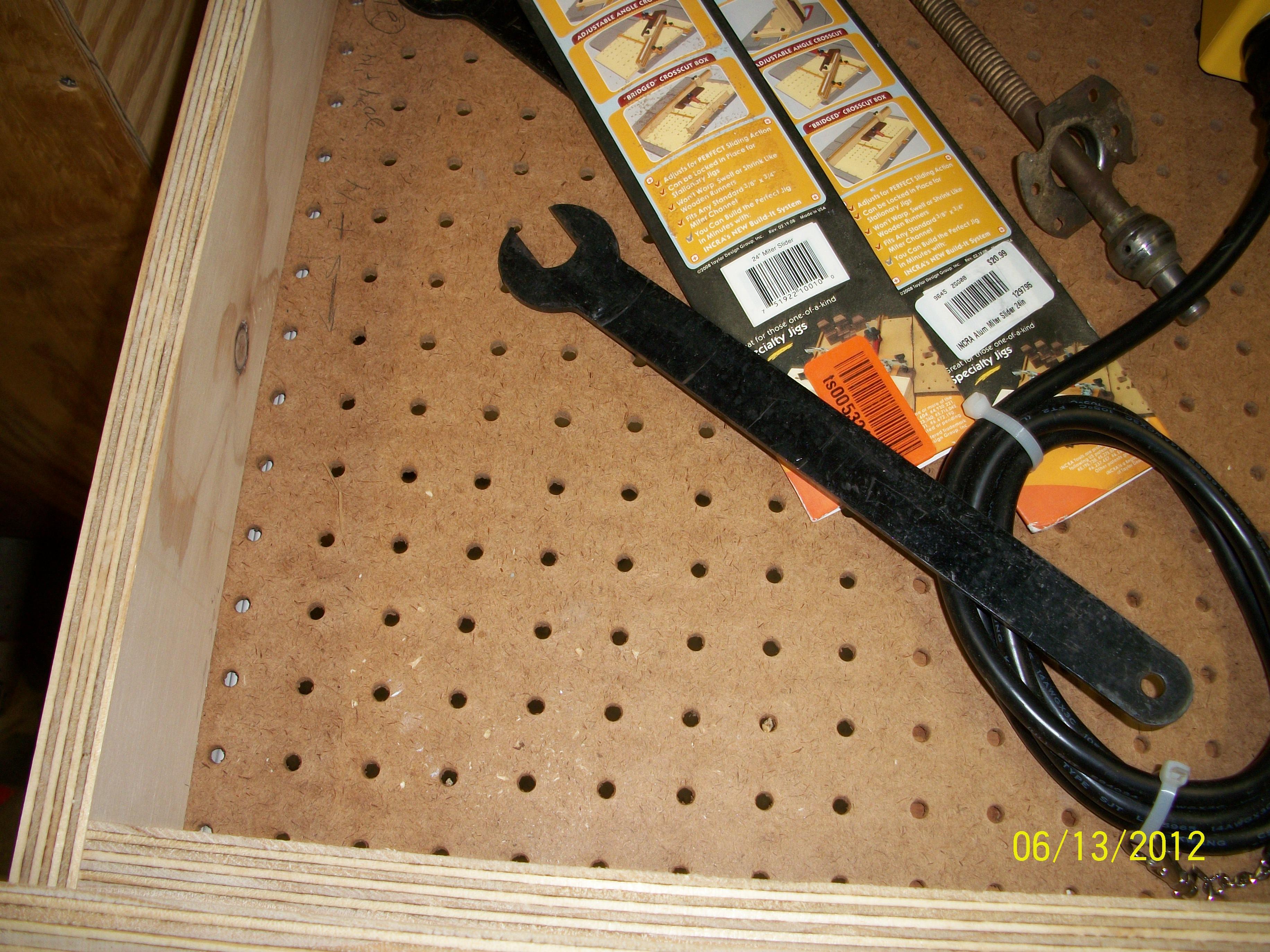

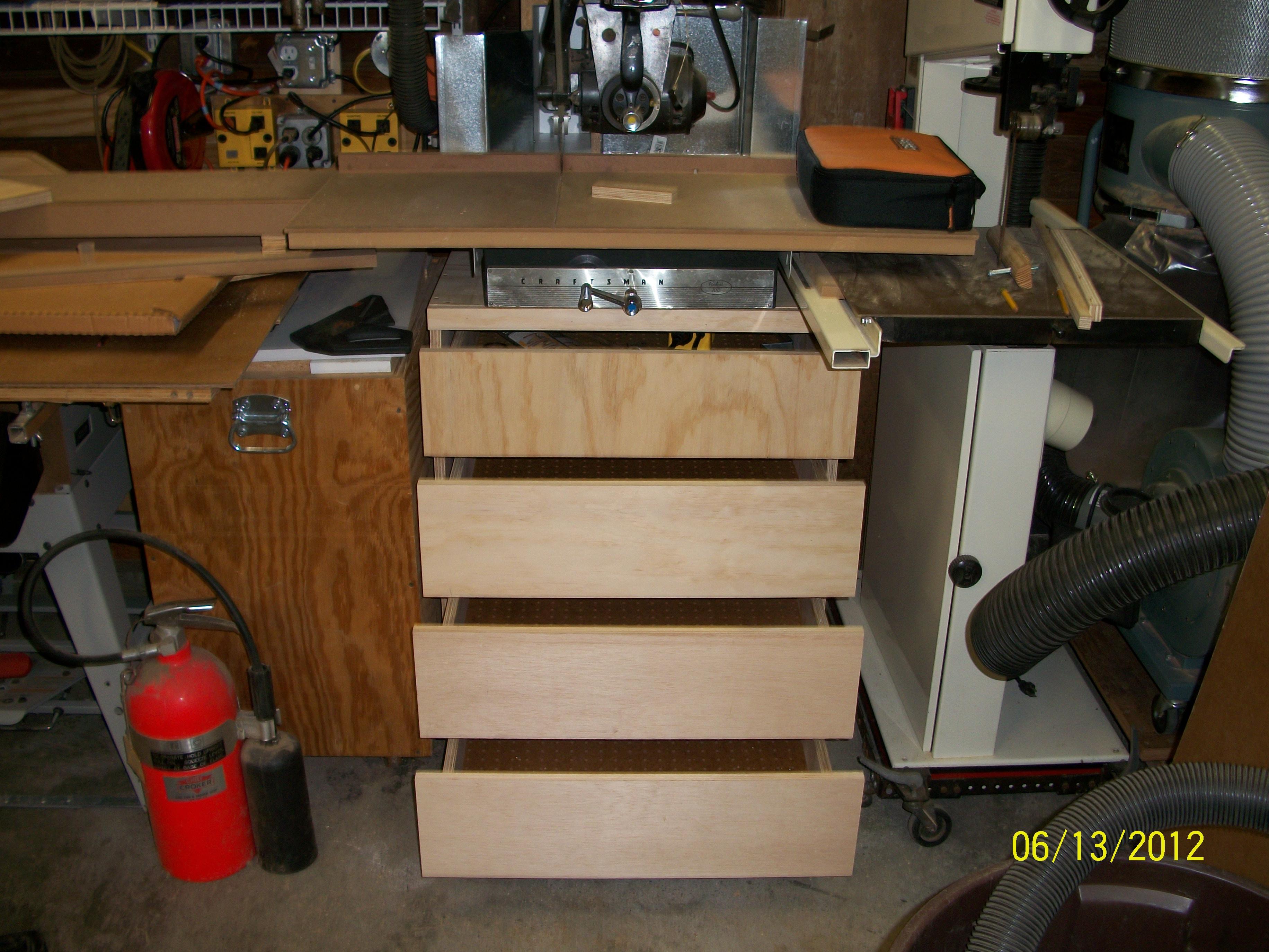

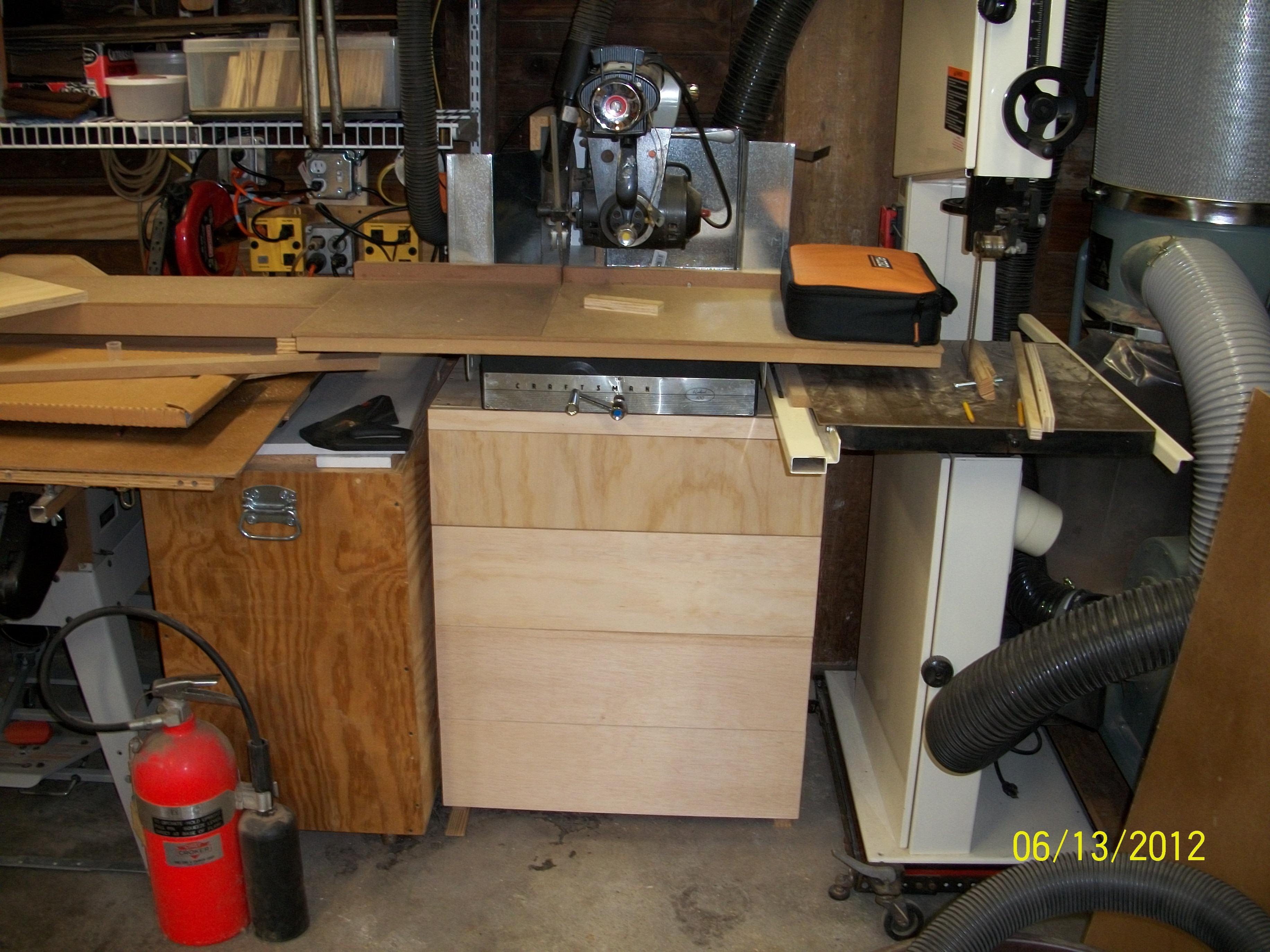

    over the last two weekends, i invested in 2 sheets of plywood for a cabinet to support my RAS. it's my first attempt at a freestanding cabinet with drawers so be gentle. the top is a double layer of 3/4" plywood and the dividers between the drawers rest in side and rear dadoes. i realize now that wasn't really necessary, but i wasn't sure when i started that i'd want the drawers and i wanted to try doing it that way anyway. the drawer runners are what i removed from the kitchen cabinets when i installed soft close Blum runners. the bottom of each drawer is 1/4" pegboard as i had a 4'x4' piece around the shop. the drawer fronts are from whatever 3/4" ply i had left over from other projects. any suggestions for shop made drawer pulls? i thought i saw something in shopnotes that used pvc pipe but i can't find it using their search feature.
    Nothing to be gentle about....Looks good to me!

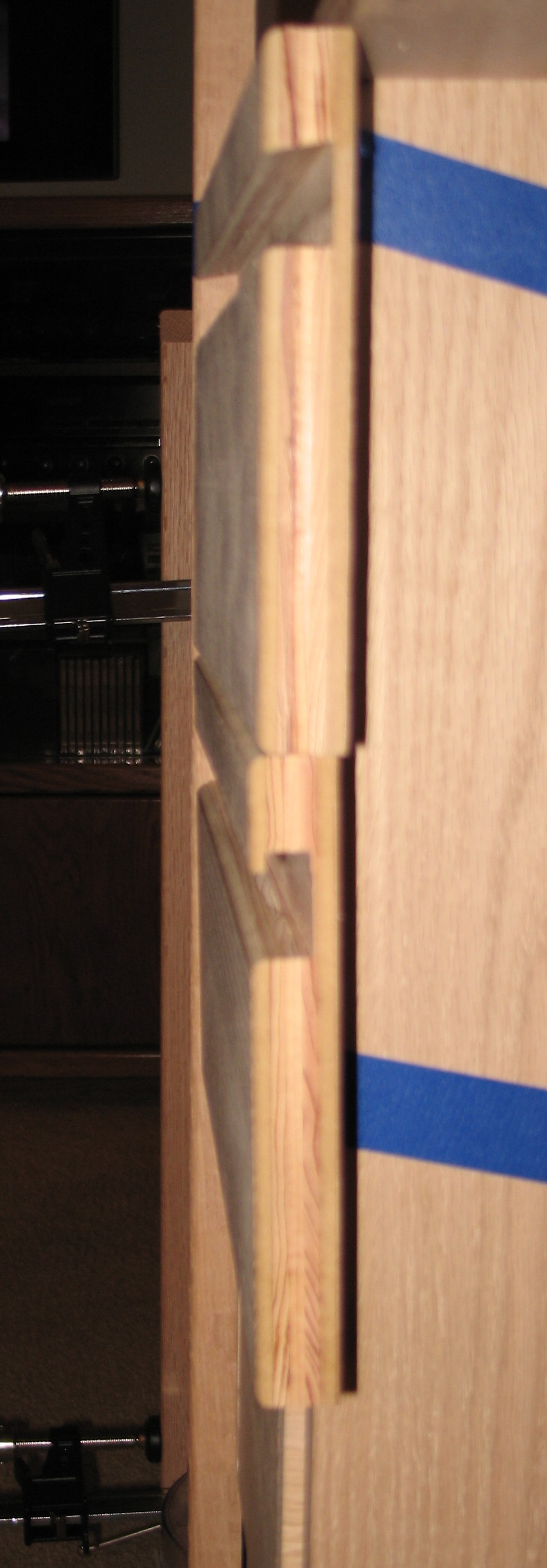

      Another way, which works for on drawers with a false front, and what I did on an entertainment center recently:
      * Run a 3/4 to 1 inch groove across the face of the drawer - in my case, it ran edge to edge. I used a basic dado stack in the table saw to make these...
      * Use a T-slot router bit to undercut one side of that dado/groove. Run the bit at two overlapping depths to make a slot big enough for your fingers. The end result should have a "T" slot shape at the top of the groove only and look like a regular dado/groove along the lower lip
      * use a roundover bit in the router to ease the lower edge of the dado/groove so the backsides of your fingers won't have a sharp edge to catch on.
      * Lightly sand the inside lip of the "T" to knock off the sharp edge.

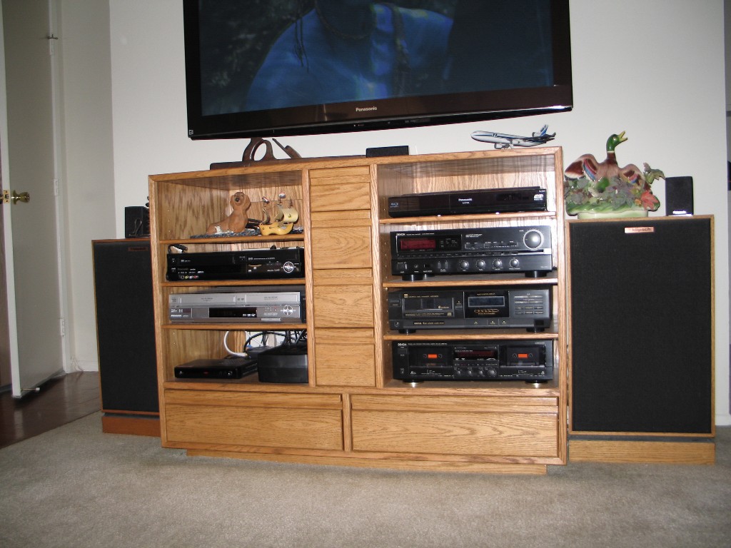

      Worked well for my cabinet - gave it a modern look and the resulting "handles" don't stick outwards from the drawer fronts. Pics of my trial/mock-ups attached; the lower mock-up shows the handle. The mock-up above it is easier to make but didn't work as well: there isn't enough "lip" to grab. And a pic of the completed project to show how the resulting "handles" don't stick out - something to consider on a tool support cabinet. Whacking knees into drawer handles sucks.
      For cabinets where looks are less critical you could probably mimic this by using two pieces per drawer: a large rectangle below and a simple stick for the top grip part - just separate them to make the groove/dado.
