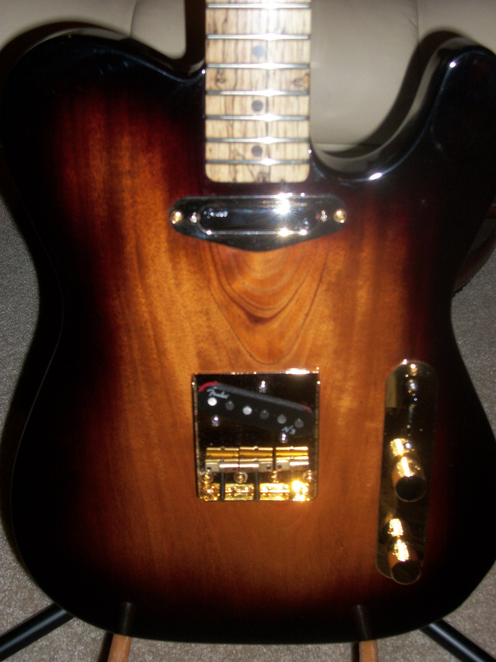

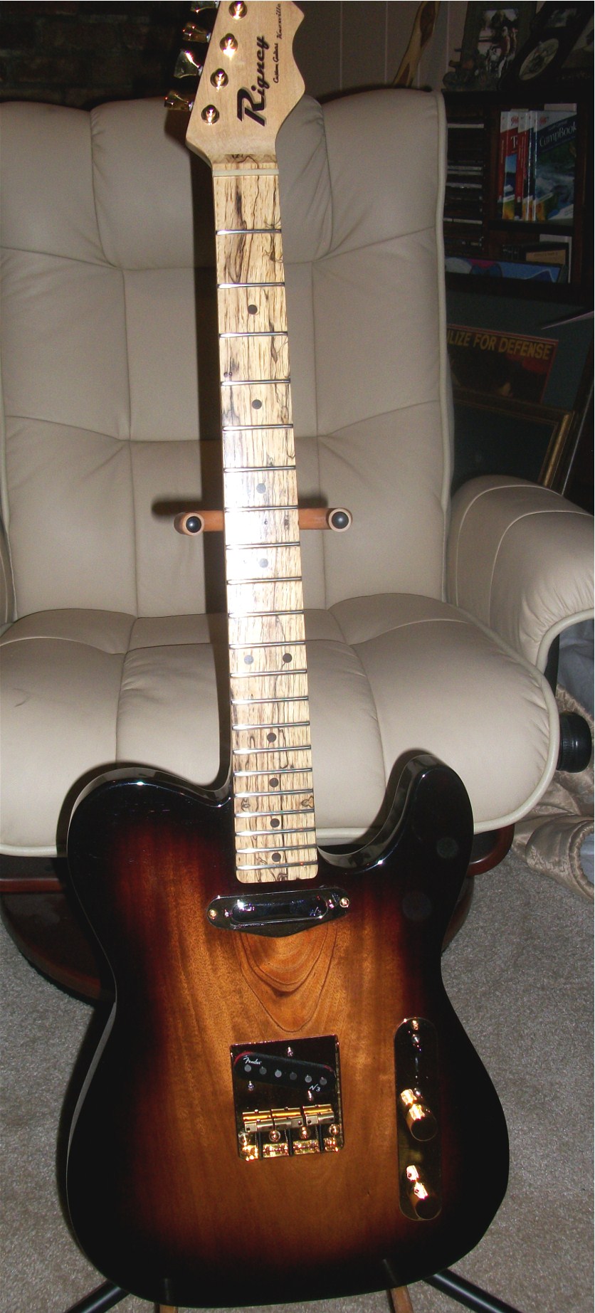

          Here are a few pics of my in progress build and my most recent completion. The completed guitar is African Mahogany with a Maple neck and Spalted Hickory fretboard. The neck was an experiment that I did not expect to work out. If I failed I could always use it to smoke a Brisket. The body is finished in Nitro Lacquer and the neck with Tru-oil.

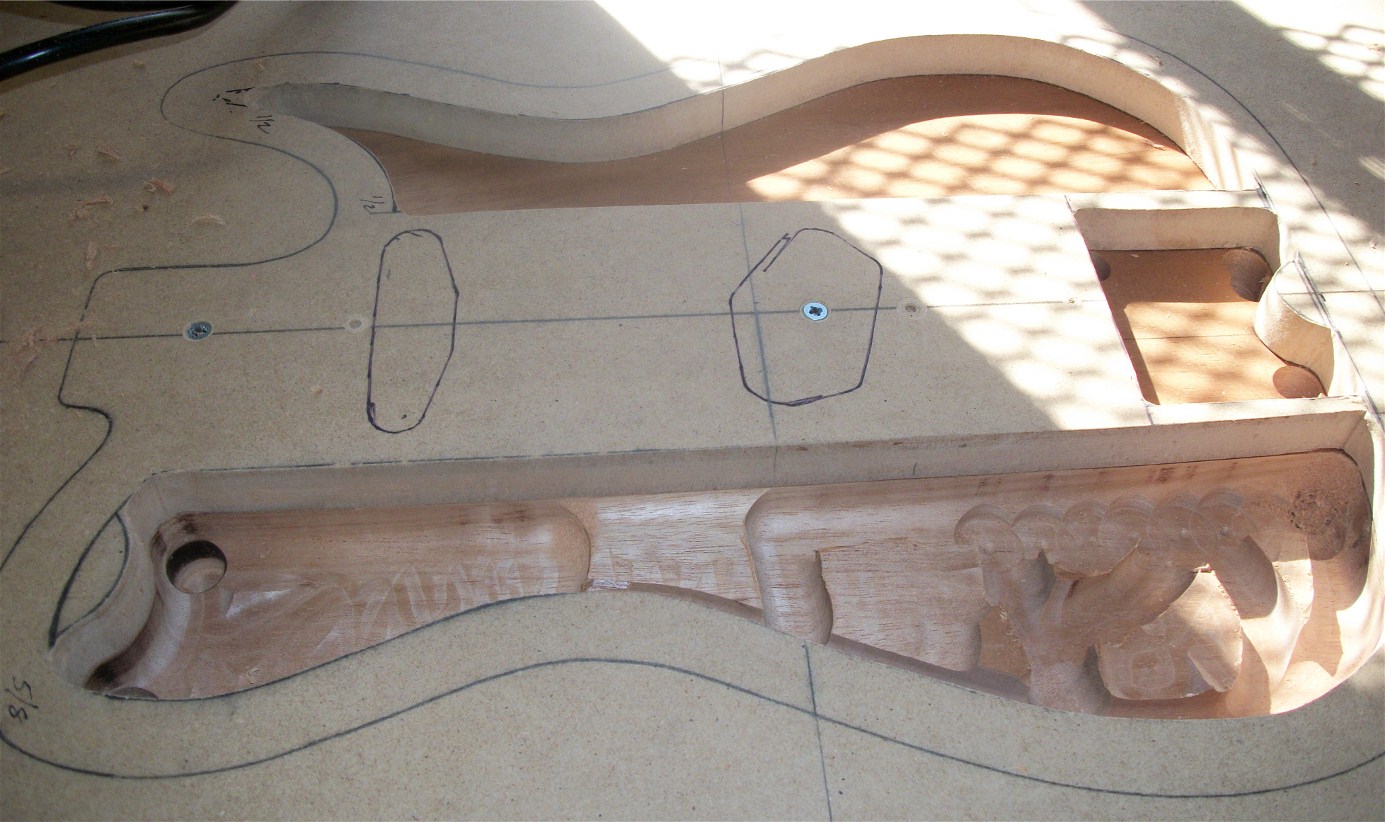

          The new build is also Af Mahog (I got a great buy on a 6' x 16" x 6/4 piece) that I am chambering to reduce weight. The top will be bookmatched figured Bubinga.

            I really dig how you centered the knot with the neck.
              All that I can say is WOW! EXCELLENT!

                Thanks guys. This is how I am keeping myself busy in retirement.
                TK- the body I show in the next pic with template attached has the other half of that knot. It will be at the base of the new guitar.
