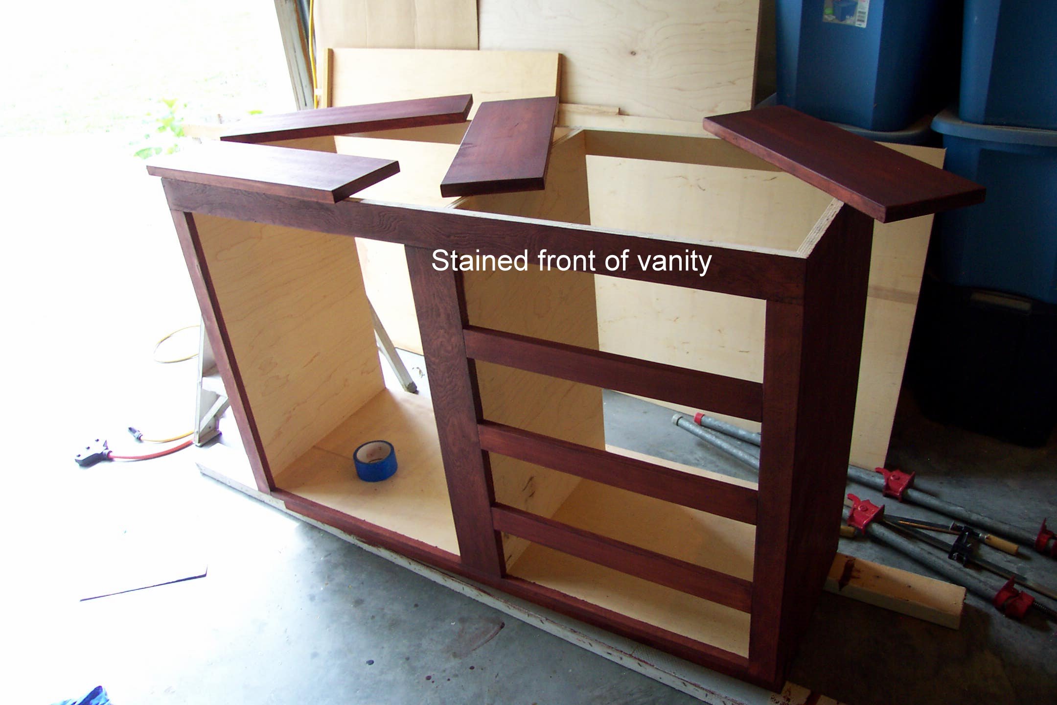

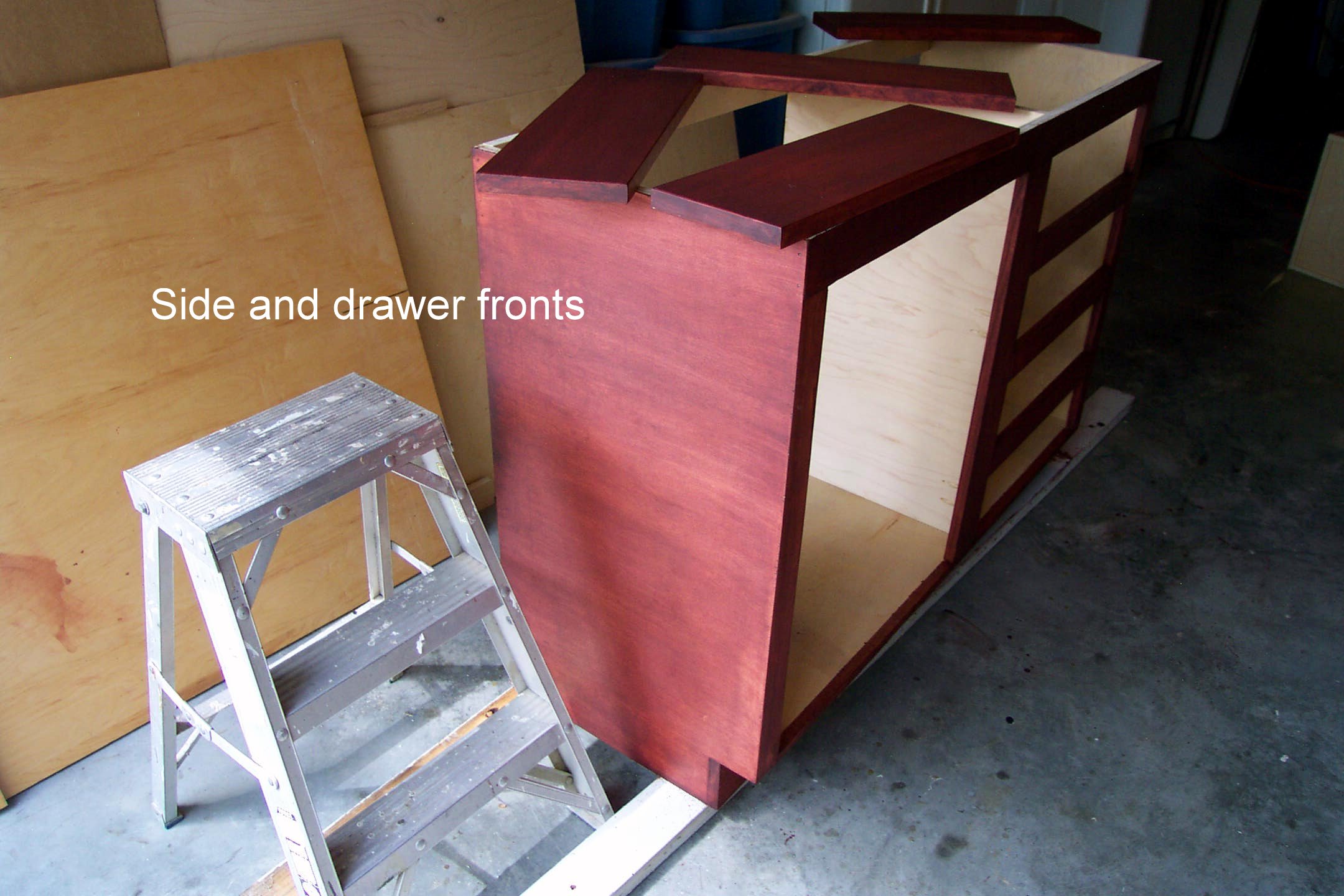

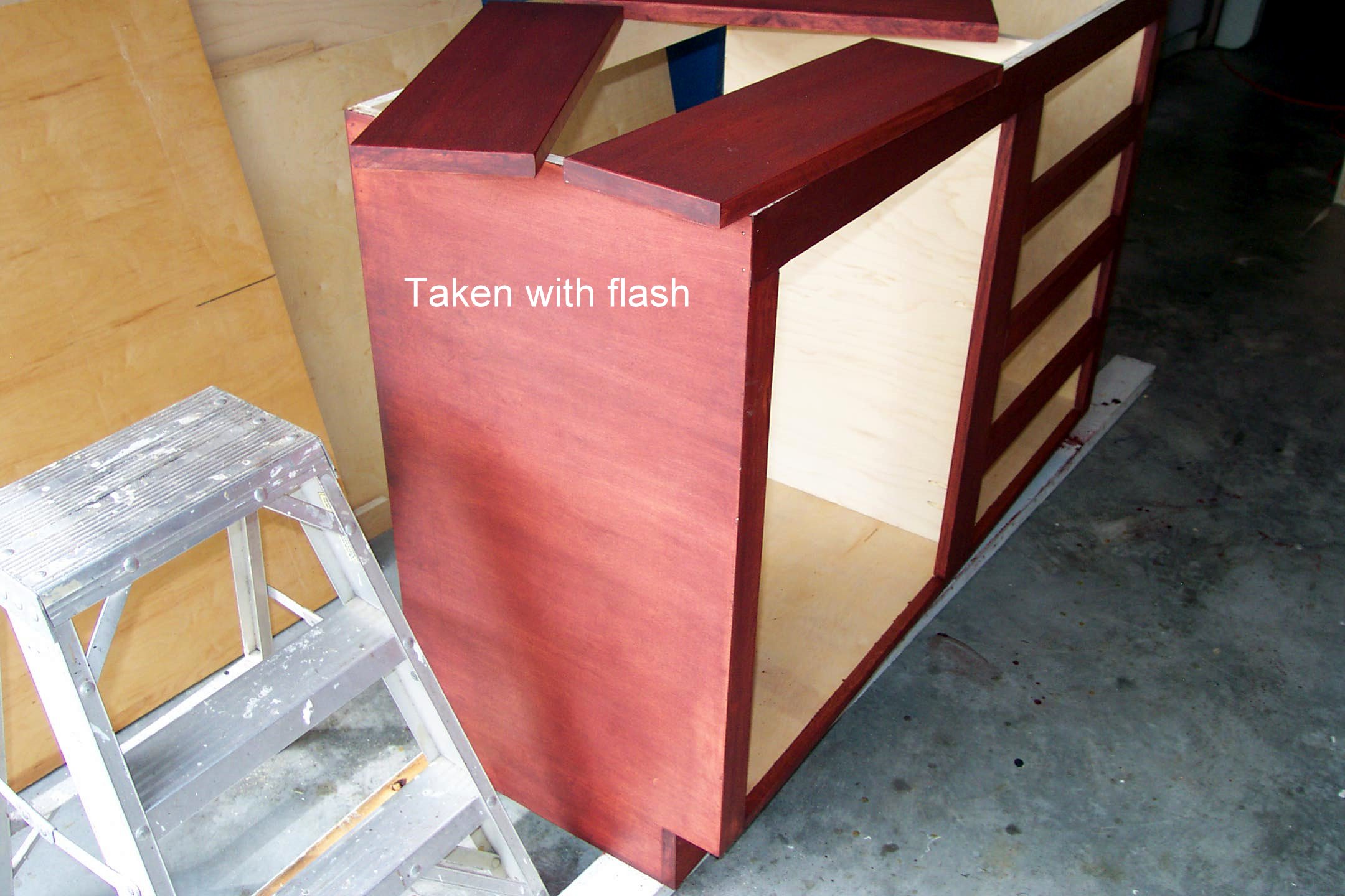

              I went with the 180 paper.
              I am using a Bosch orbitol sander (takes a quarter sheet).

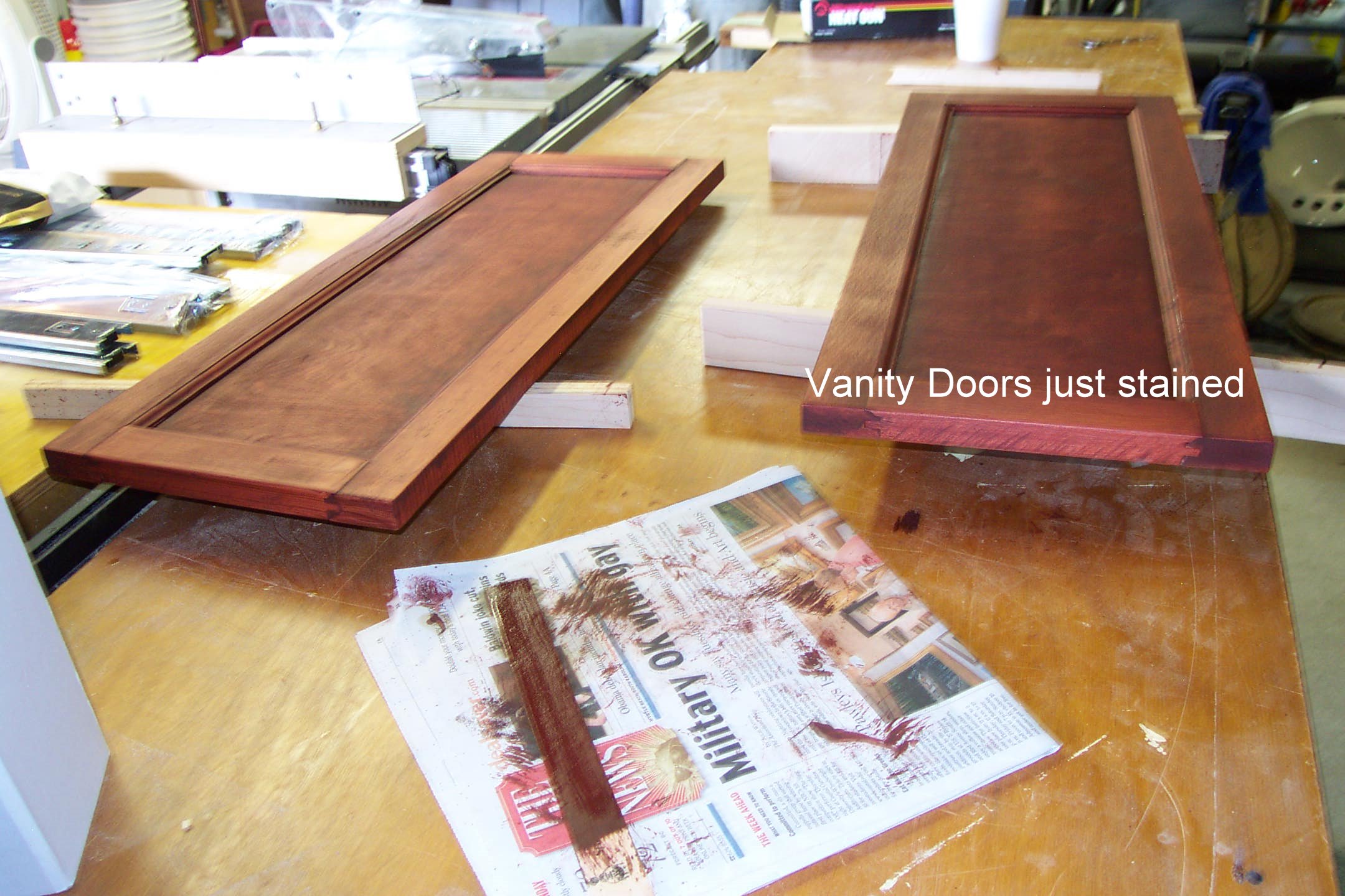

              I used a brush to apply the stain (Sherwin Williams brand) and then wiped it off with wiping towels. I did the main unit yesterday along with the drawer fronts. Just finished the doors.
              The stain from yesterday is still a little wet. Can I use a heat gun or fan to hurry it up?
              There are a few areas darker and lighter, but to me it gives it some character.
              I am leaving the drawers and inside unit natural so it won't be so dark inside.
              I will finish it all with either sprayed on lacquer or poly. I have been using water based so I will probably give it a try.
              Here are a few pics thus far.
              Thanks,
              Conwaygolfer
                It looks good so far. I wouldn't use a heat gun. I would let it dry on its own.

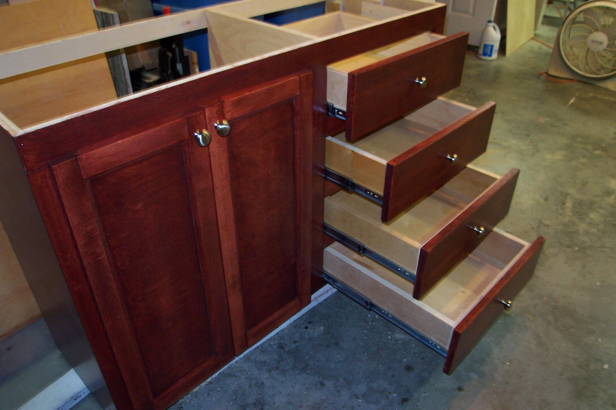

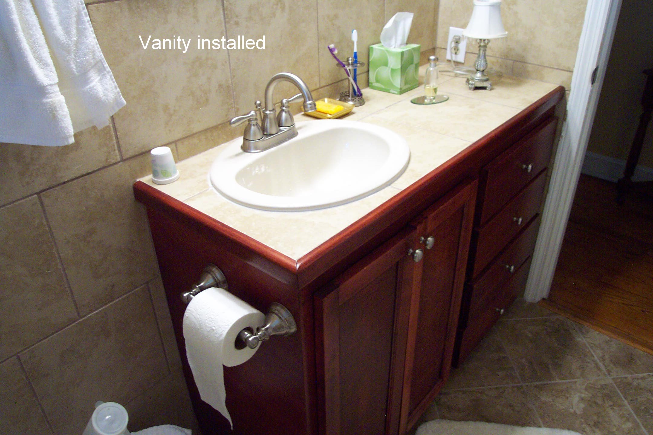

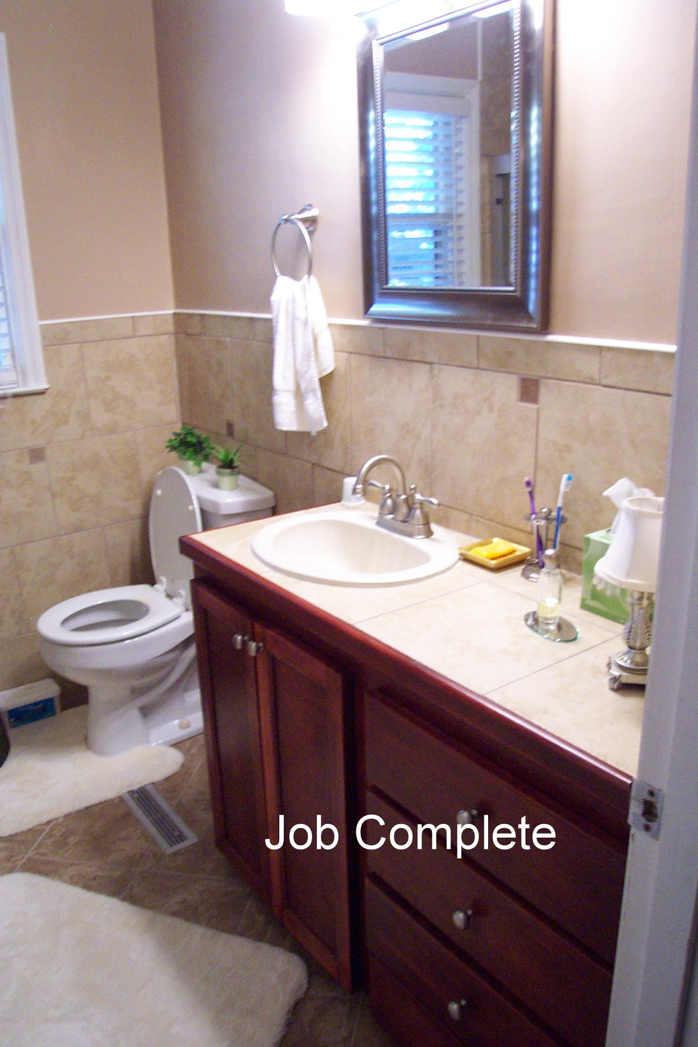

                  A few more
                  pics of the completed vanity. This was done for a lady I go to church with. She had me install the tile on the walls and floor and also on the vanity top.
                  The vanity was stained Red Chestnut and I used full extension glides on the drawers. The finish is 5 spray coats of lacquer (satin) The tile on the top is the same as I put on the walls.
                  The drawer fronts are solid maple.
                  Thanks,
                  Conwaygolfer
