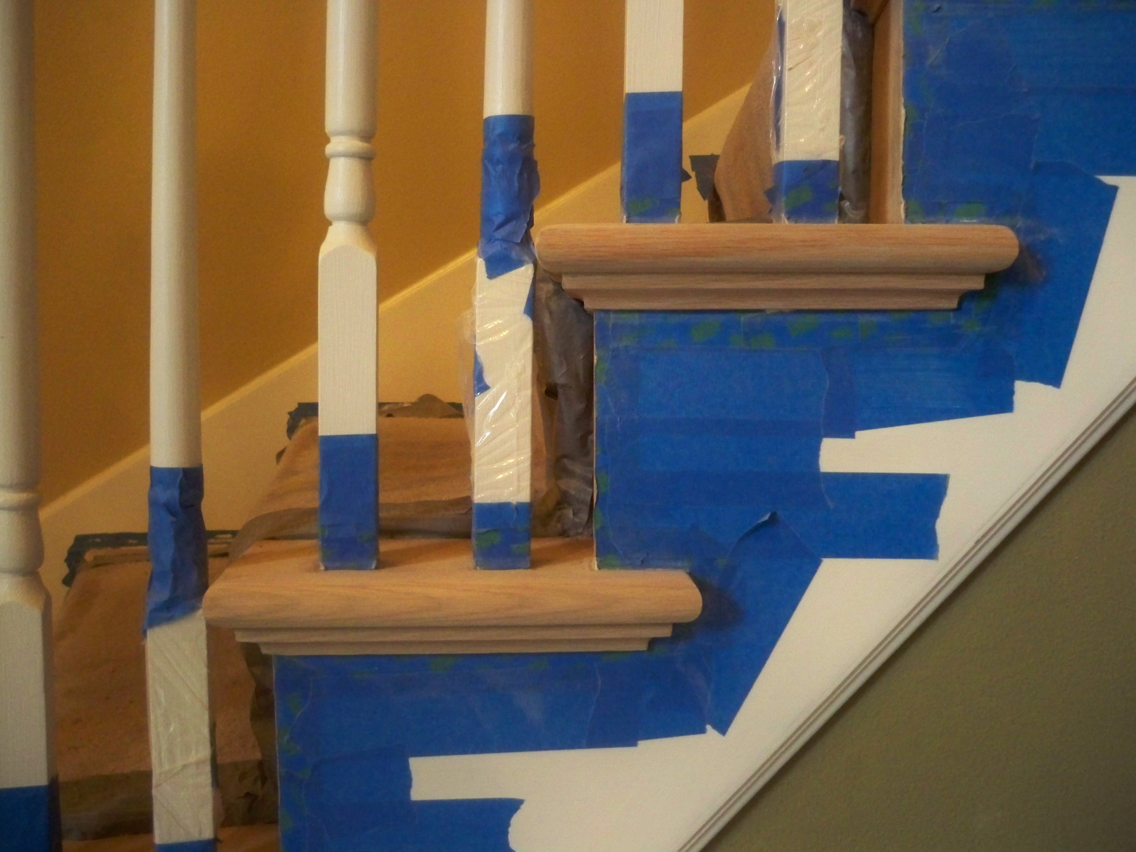

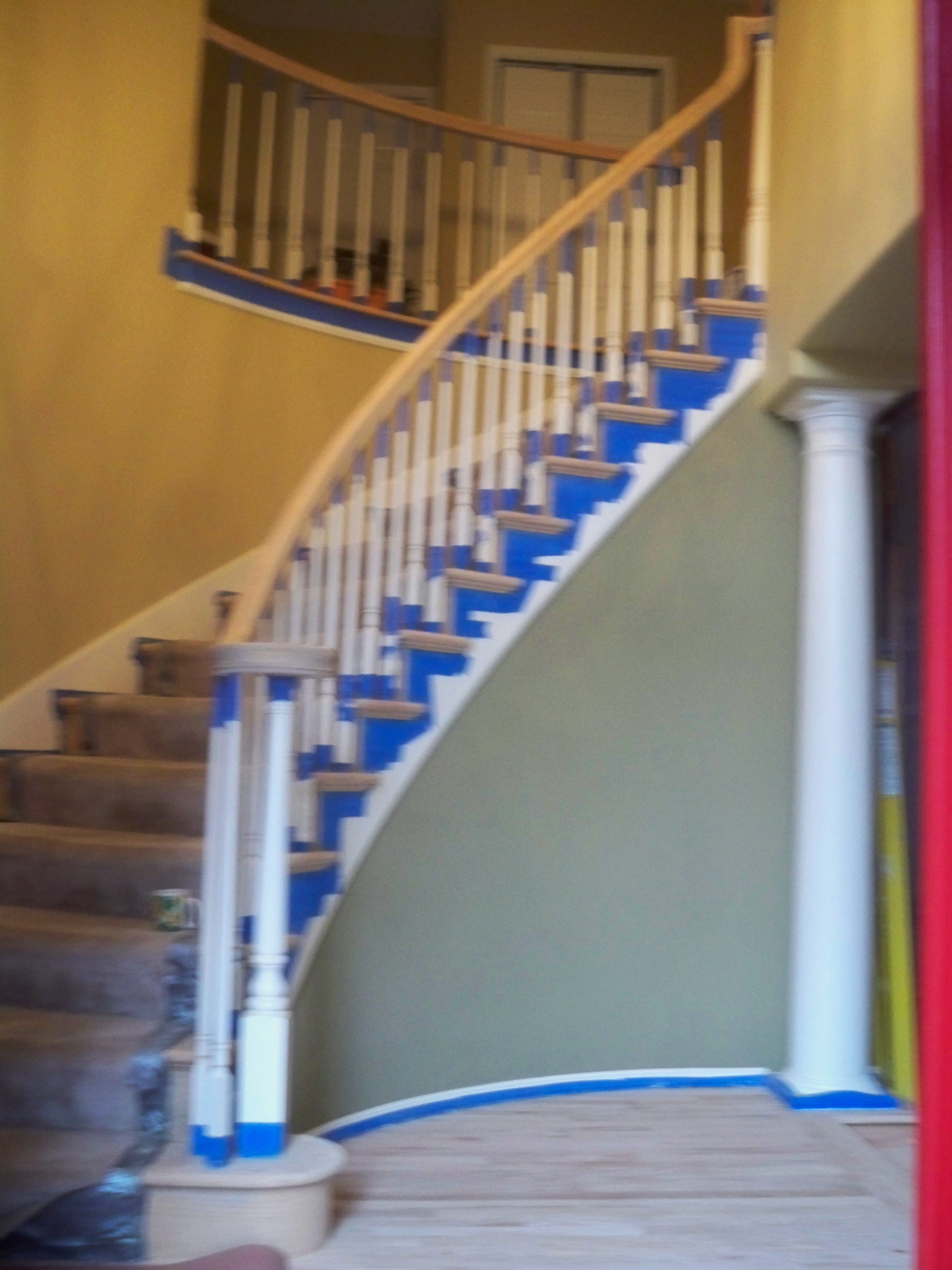

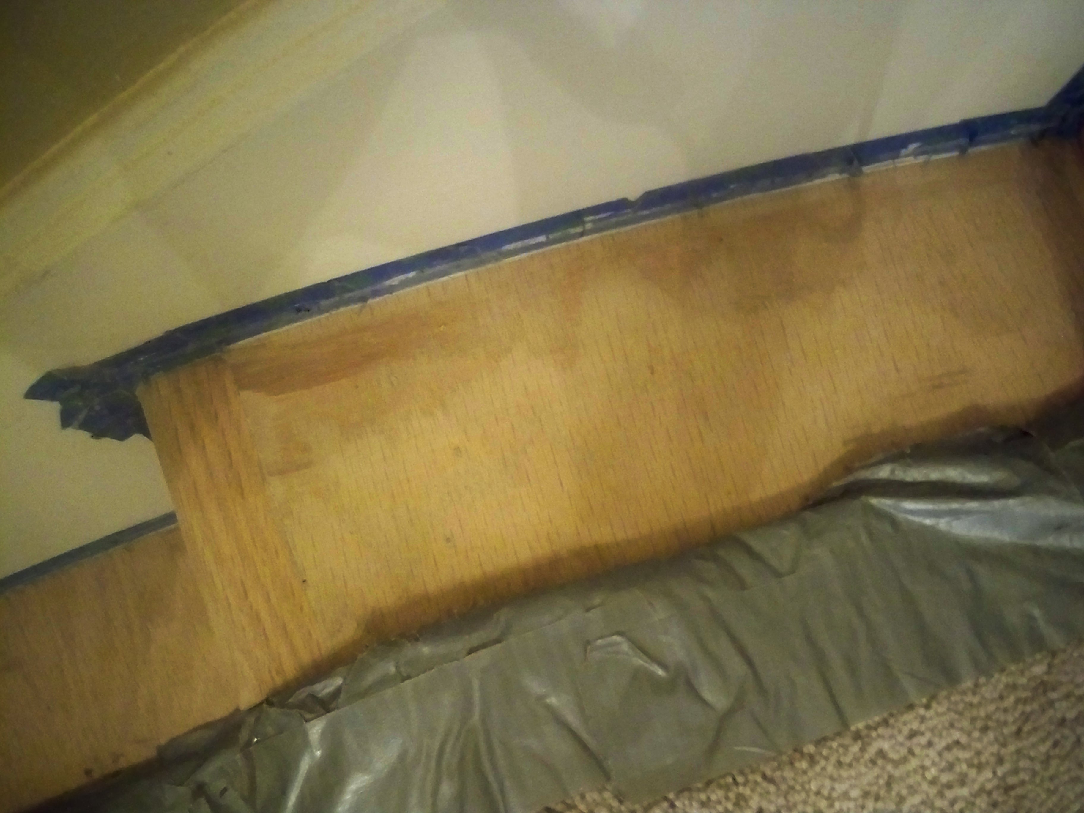

          I thought I would post some pictures to give a better idea as replacing them sounds best ( $608 for tread / riser + trim costs) but would be a bear of a job. Why the builder cheaped out on the stair treads I have no clue as a curved stairway to build originally I'm sure was a lot of work.
          I also did pay the worker as it was my fault not watching him close enough. Another worker I hired for the same job lasted 30 minutes and wanted to go back to HD ..... I don't think I'll be hiring these folks for any future projects anymore !!!

            That's what I was picturing when you were describing the problem. One option would be to pull the carpet on the stairs and replace all the stairs with solid wood. After all that work, I wouldn't replace the carpet as I think solid wood would look really good. The other option would be to try to glue new veneer over the wood on the stairs. You may be able to pull the carpet back a little to hide the edges of the veneer. The problem will be the drop off from the veneer to the bull nose. I don't see any easy solution except to make the stairs your next project.

                It looks like the plywood has a solid wood edging... if that is the case, why not trim the plywood edging flush with the white wall trim, reveneer the ply and then put new solid edge treatment, caulk the very fine joint between the wall and the white trim.

                  Great feedback everyone as it got me thinking of a hybrid of these ideas. What about a vertical cut down all along the skirt board to get out the veneered plywood / solid wood bullnose trim and then replace with new solid wood treads on that side. I would have a template for the curve for each stair and also wouldn't have to mess with attaching the bullnose trim or veneering each new four inch wide piece. Faster & cheaper as I would only need to buy / cut to fit one or two full treads versus thirteen.
                  Downside is a mismatch between the left and rights sides as to how it was built originally but I don't think you would notice it much as there's 40 inches of carpet between them.

                    Looking at that pic, the use of plywood now makes sense.
                    In my older (slightly post WWII) house, they nailed everything. All solid lumber, no plywood anywhere. I get creeks and I can see open joints and observe the wood move.
                    In newer higher-end construction, they use glue and (often pocket) screws on stair cases. They may have used the plywood treads due to the odd shapes of them.
                    I think you're going to find it difficult, if not impossible, to remove either the treads or risers without a substantial fight.
                    I think I'd replace the carpeting going as wide as possible (flush to the wall on one side). Paint the treads/risers on the railing side, if need be.
