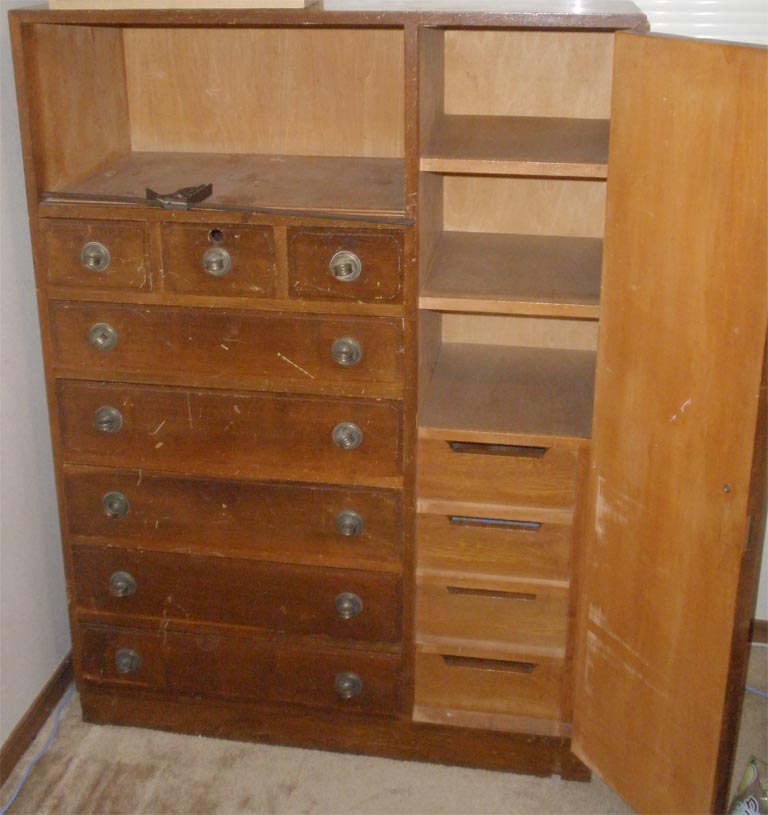

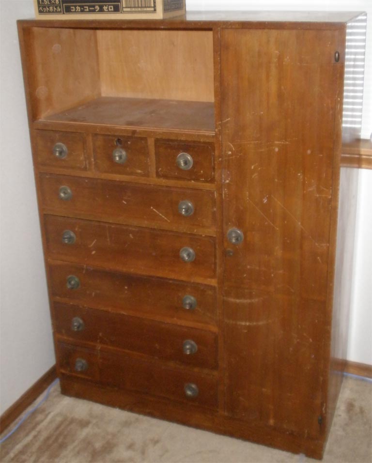

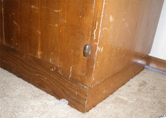

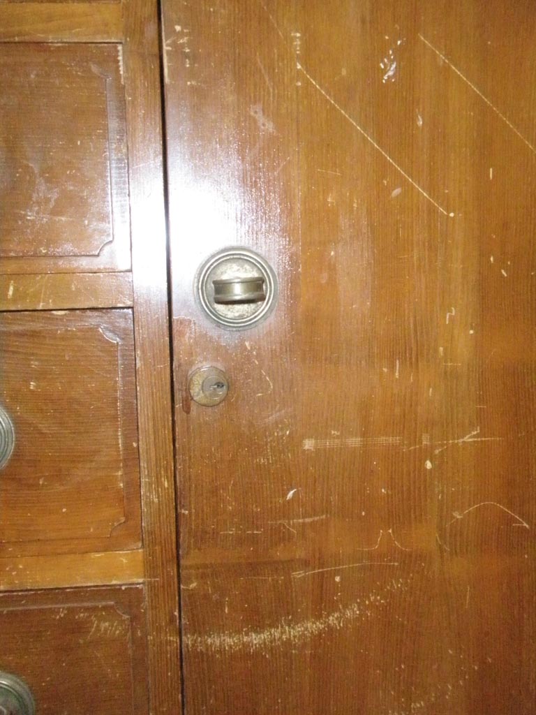

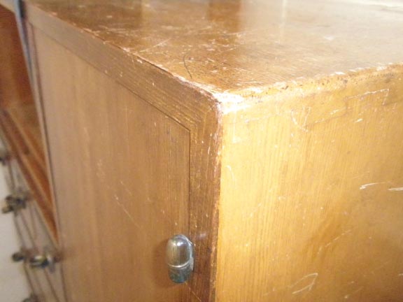

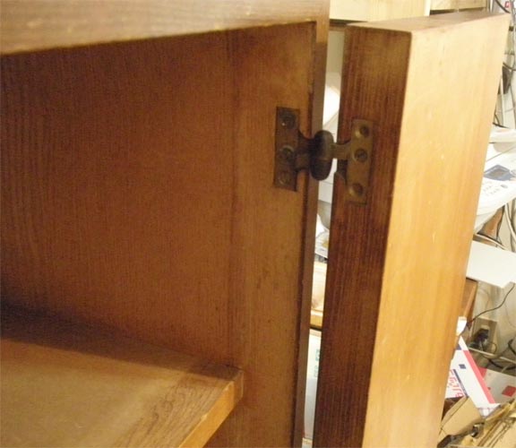

              I will see if these upload OK.
              This is the same condition that I found it in about 15 years ago. The finish looks terribly scratched and it was but only on the surface. None of the scratches are beyond "finish" deep, and it was like that when I found it.
              I always wanted to refinish it but never had time. My daughter was really irritated at me for not bringing it home and I could kick myself for not doing that. It was WELL crafted, strong and surprisingly light weight for its strength. But no fiber type of boards or hollow boards in it. It is missing the sliding doors for the open top above the drawers.
              The carcass was made from Japanese elm, the drawers behind the face were a type of fir.
              For sizing, see the 24" Starrett square in the second picture in the opening.
              Also, notice closely the third picture - of the rounded dovetail corner joints

                Thanks for the pictures Hank. It's an impressive cabinet. Those hinges are something else. Doesn't look like they have any adjustment capabilities.
                • RAFlorida
                  • 1179
                  CabinetMan beat me to the post about
                  those hinges. They look unique. My Uncle was in Japan back in the 50s and always commented on the quality of the cabinets and drawers being truely tight tolerances. Thanks for sharing your pictures; and I agree with your daughter.
