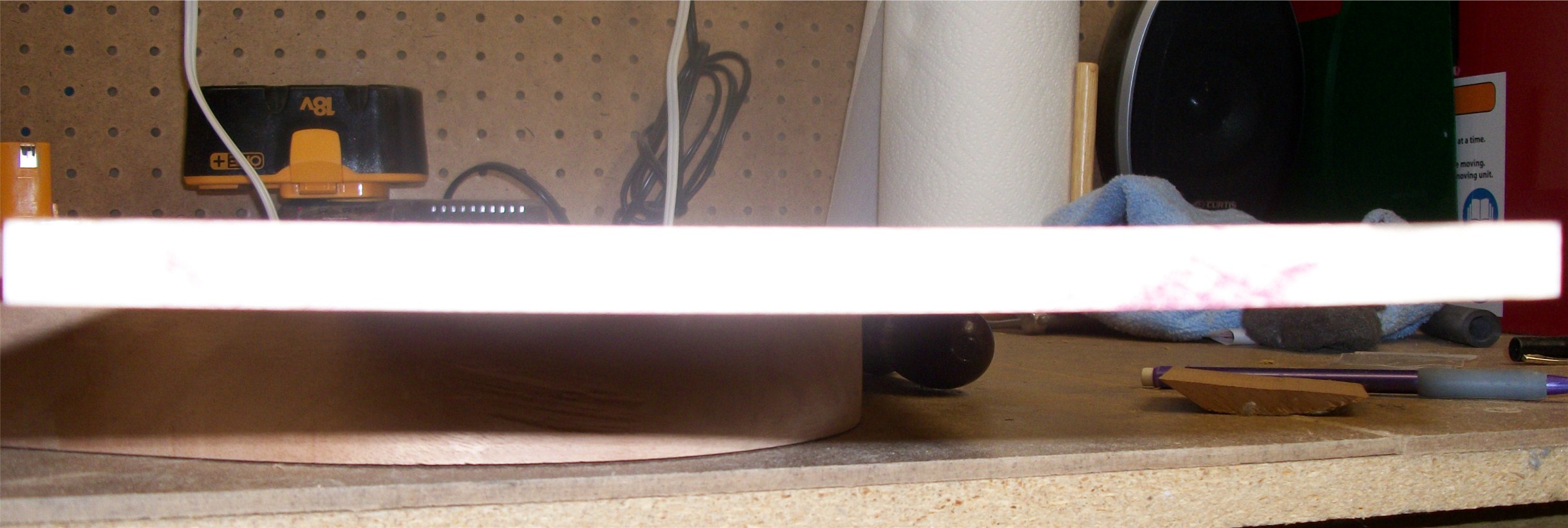

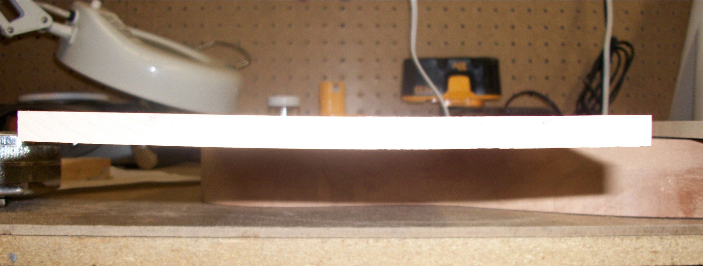

                      • SSO720
                        • Jan 2011
                        • 29
                        • Knoxville TN
                        Here are pics of the wood I am working with. I have since wet both sides and clamped it to try and flatten the warp. Will see what happens.
                        • crybdr
                          • Dec 2009
                          • 141
                          • Lake Mills, WI
                          Ahhh...
                          From the pics, I see that you've already cut the shapes for the halves of the guitar face.....I didn't get that the first time...
                          Wood is 'alive' and will 'move' depending upon moisture, grain, where it was cut from the tree, etc. It's a truly unsuitable medium for 'precision' work - but that's what makes woodworking fun.
                          If I was in your shoes, here is what I would do. I'm a newb, so if others disagree...please speak up!
                          1. Let that wood dry out from the water you have applied. I'm questioning whether or not soaking and clamping will improve your situation - probably not, it's pretty thick - and it's difficult to glue 'wet' wood. I'd bet that when you release those clamps - the wood resumes it's cupped shape. If not, that's awesome!
                          2. Get all of your material in order and ready to glue - make sure the substrate you plan to glue this to is square, flat, and stable.
                          3. Run the 'bottom' faces through a jointer (IF you can do it safely considering the shape you have - it's not a rectangular board anymore). This should give you a flat gluing face on the bottom. 'Snipe' is a big issue here, considering you've cut the shapes to size already, so watch for it. 'Snipe' is usually a 'planer' issue, but it can show up in 'jointer' work as well - depending on technique and pressure applied.
                          4. Run the 'seam' through the jointer using your 'new flat bottom face' as the guide against the fence (again, safety first, considering the shape of your wood). Assuming a 'dead on' right angle of the fence to the bed, the 'seam' should now be square to the 'bottom face', and should result in a flat board after 'edge gluing' them together.
                          5. Here's where it gets 'iffy'..... You could 'edge glue' the boards together and wait until the joint dries completely. This should take about a day for a strong bond. You need a 'dead on' alignment of the pieces here, to ensure a flat face across the entire 'bottom face' of the board (this has NEVER worked for me - always resulting in 'sanding-out' the slight misalignment). Additionally, the wood may 'cup' in either direction during that time. Hard to know how much it might move....If a 'cup' shows up, and it's MINOR, you could probably force the wood onto the substrate - the edge bond should be strong enough. If the 'cup' is PRONOUNCED, can you bring it somewhere to have it's bottom face jointed? It's a wide piece at this point - not what the home shop can usually handle. 'Snipe' could also show up here - so beware.
                          Alternative #1, You could try some complex clamping....gluing the 'edge joint' and the 'face glue' to the substrate at the same time. This would be complicated, and I wouldn't have enought clamps to do it right - but it's theoretically feasible. I probably wouldn't try it.
                          Alternative #2, You could skip the 'edge gluing' and do the 'face glue' of the individual boards to individual substrate pieces. Given the width of the boards, you could probably 'clamp the ****' out of them to reduce some of the potential cupping, relying on the bond between the wood and substrate to create a more stable combination of materials. Then, once both halves are glued and stable, joint 2 faces to give you a square 'edge glue' right down the middle.
                          As I think about it, Alternative #2 would work best given the tools in my shop. Because you would be working with 'bulkier' pieces, jointing the faces seems to be easier.
                          Again, I'm just guessing on a fix for your dilemma, and throwing out an idea of what I would do here....Hopefully, others here can add more input and alternatives. The fact that you have the pieces cut to shape already poses a particularly unique problem. And, you haven't done anything wrong, wood moves all of the time.
                          Good luck,
                          crybdr
                            I know that you have it at about 5/16 or so at the moment and do not know if you intend to keep it at that or sand it down to a thinner face for the guitar or not. However, once most wood gets down to about 1/8", its expansion / contraction and warping can be controlled much more easily.
                            Wood moves with humidity changes for sure, but have you ever noticed that fine veneer on fine furniture doesn't? Once most wood gets to the 1/8" stage, its characteristics change. Being glued or saturated all the way through with finishes, it is less likely to move or warp. But it must be in the final shape or close to it when finish is applied or glue is applied (as veneer.)
