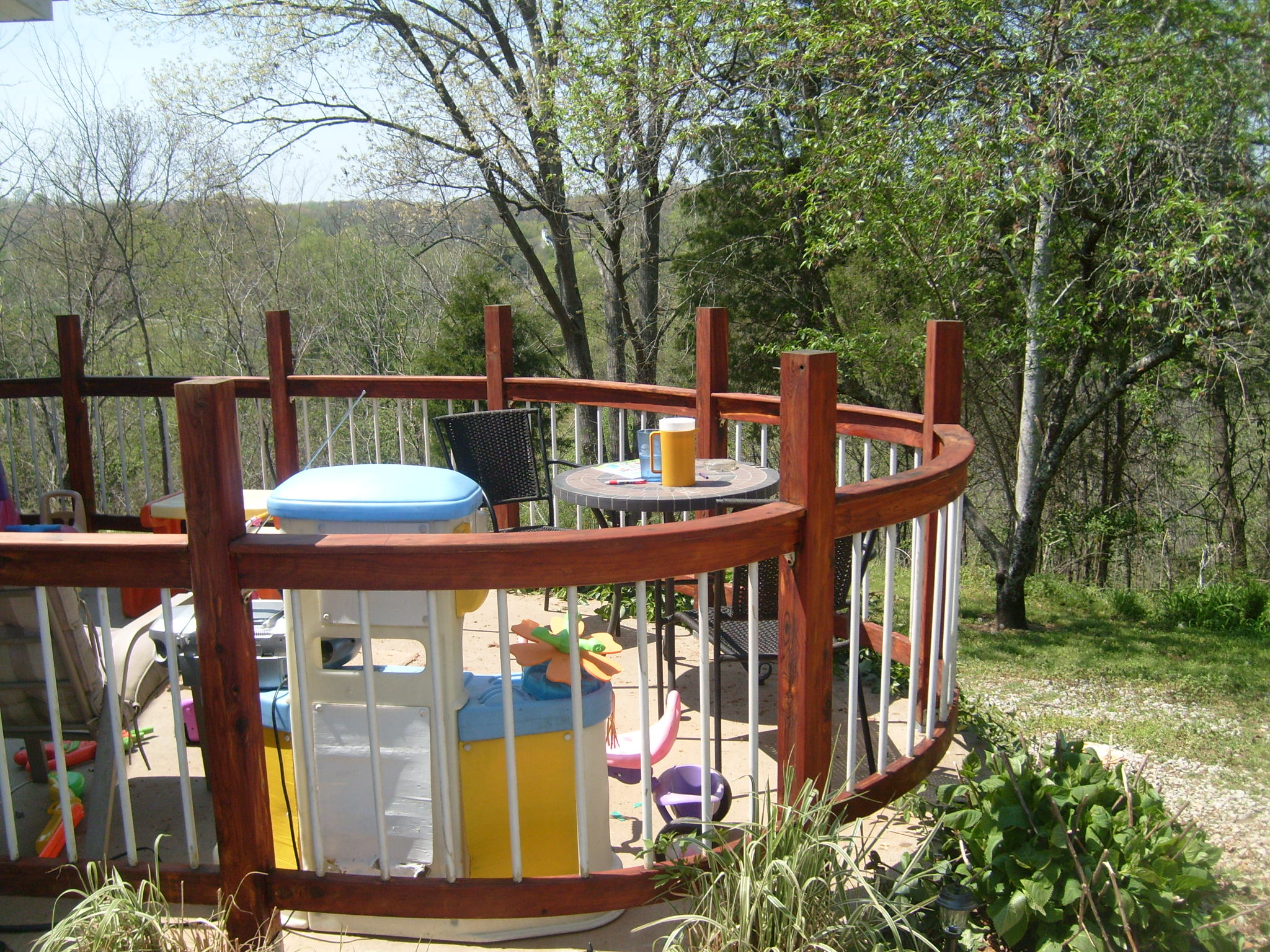

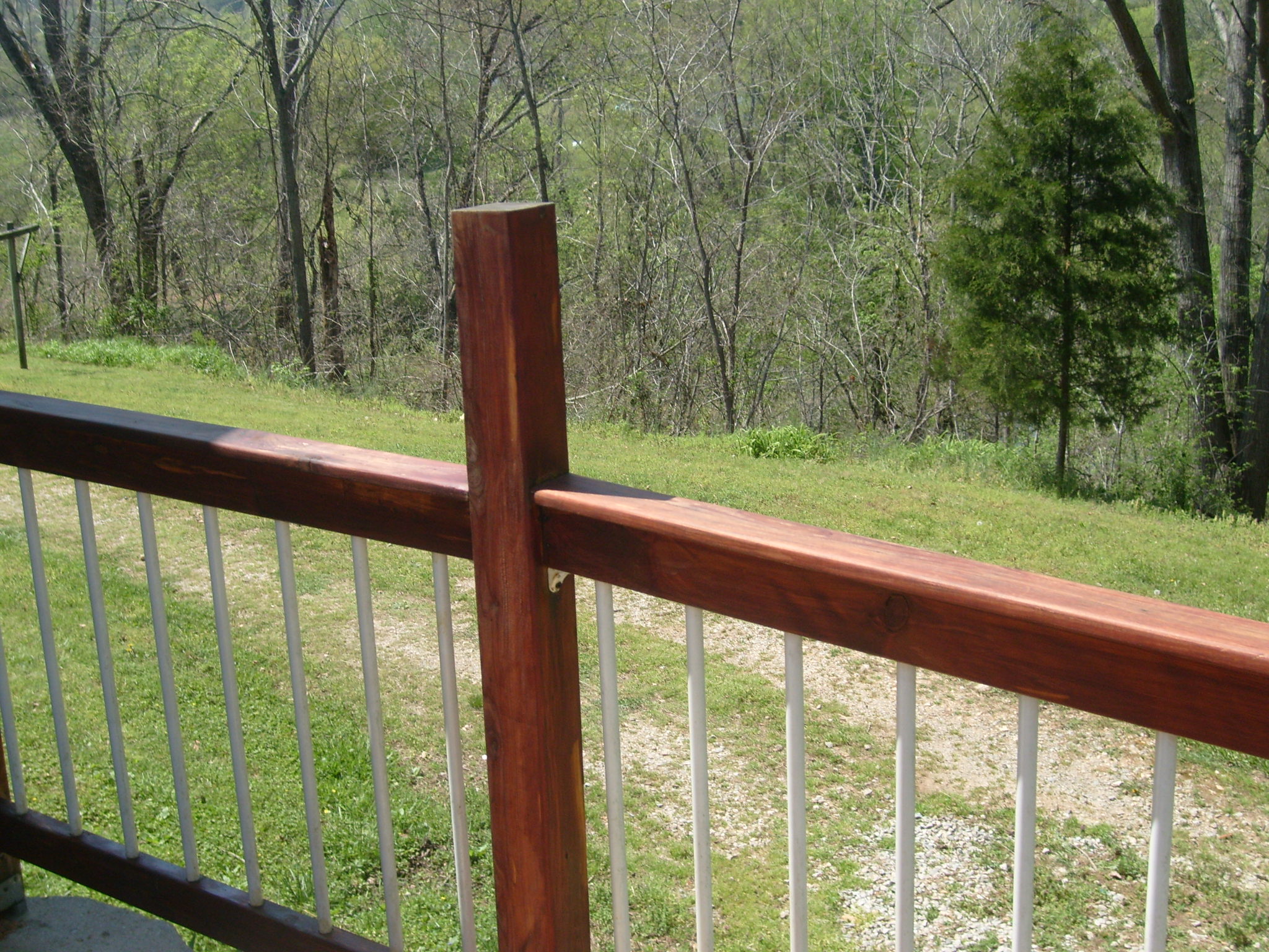

                        Checking back in after a long weekend of scraping and sanding. I got the Penofin Red applied, and it looks just wat I was shooting for.
                        Thanks again.
                        It absorbed fast, and wicked the excess. it only took one coat, so I have a bunch left over. I reckon I need to get more cedar for some chairs?
                        Tip for anyone thinking about using this product. Keep lots of rags handy, you'll need them. The instructions call to wipe the excess after 30 minutes.
